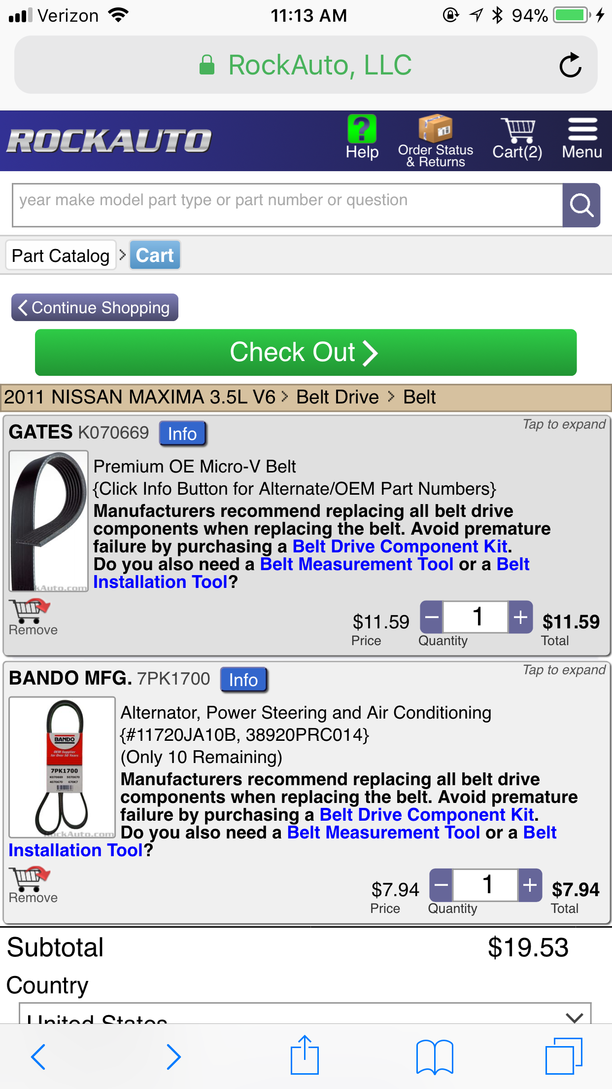

Old Dec 11, 2017 | 02:41 PM
Les7311's Avatar
Joined: Mar 2008
Posts: 780
From: maryland
Thank you. Which belt do I need from rock Auto?

Old Dec 12, 2017 | 05:20 AM
wildcat08's Avatar
Joined: Feb 2014
Posts: 58
From: Oklahoma
I would consider getting a Nissan belt either online or at the dealership. Part # is 11720-JA10B. I know I am not the only one who had endless problems with aftermarket belts squealing and chirping.
Old Dec 12, 2017 | 06:07 AM
Les7311's Avatar
Joined: Mar 2008
Posts: 780
From: maryland
Thank you wild....... this info is perfect for my deciding.
I have 130k miles and the belt after inspection looks great. But I have some days off so surgery is in the makings.
Appreciate the prompt response

Old Dec 13, 2017 | 06:17 AM
Les7311's Avatar
Joined: Mar 2008
Posts: 780
From: maryland
Stealership cost is $70, eBay OEM is $30.
