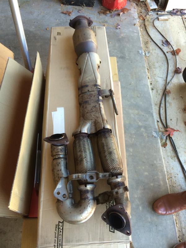

Old vs new y-pipe. The factory pipe is about 1" thick after the flex pipe section. The tight u-bend is significantly more restrictive than the larger bend, and the diameter of the pipe is much more consistent.
When ordering, you will need to get the gaskets, either from them or a parts store.
You will also need to go to the hardware store and pick up the following:
2x 10M-1.25 x30mm
2x 10M-1.25 nut
2x 10M lock washer
The factory has studs to the mid pipe, while the RL pipe just has holes.

I already had magnaflow mufflers and high flow resonator installed.
I am very happy so far, and there is a noticeable gain in power. The exhaust note has lowered slightly, and a little bit of drone has mellowed some.
It is part placebo, but I feel the car is a bit faster to 30, and really wakes up as you go faster. There is a significant reduction in back pressure and it is noticeable.
Install tips:
Get a friend to help. It will make life much easier.
Start with the front flange, then work your way back when getting bolt holes lined up. This way the flex pipes help you.

Is it me, or does both the stock y-pipe and racingline y-pipe departed from the equal length exhaust of past generations? It seems like the rear bank has to travel a little further than the front bank. That would probably account for the deeper tone.

Something else to consider....the RL pipe has NO heat shielding and it does run relatively close to the transmission.
This may or may not cause any issues but I erred on the side of caution and covered the forward section of the Y-pipe with header wrap.

Considering the dealership just pulls off the shielding if it starts to rattle, I would say it makes no difference.
The dealer sound is from the larger diameter pipe. This is the science of standing waves.

The last generation to have a close to equal length setup was the 5th gen, its rear cat was alot shorter allowing for the rear piping to bend towards the rear of the car sooner. It also and had a single "I" shaped subframe that allowed for alot more room under the motor for tubing.
The 6th and 7th gens use a "K" type engine subframe that is alot sturdier for the chassis but allows for less exhaust routing. The rear cat on the 6th/7th gen is also facing the front on the car, to make it go too quickly to the rear would create a severe angle that would hinder exhaust flow.
