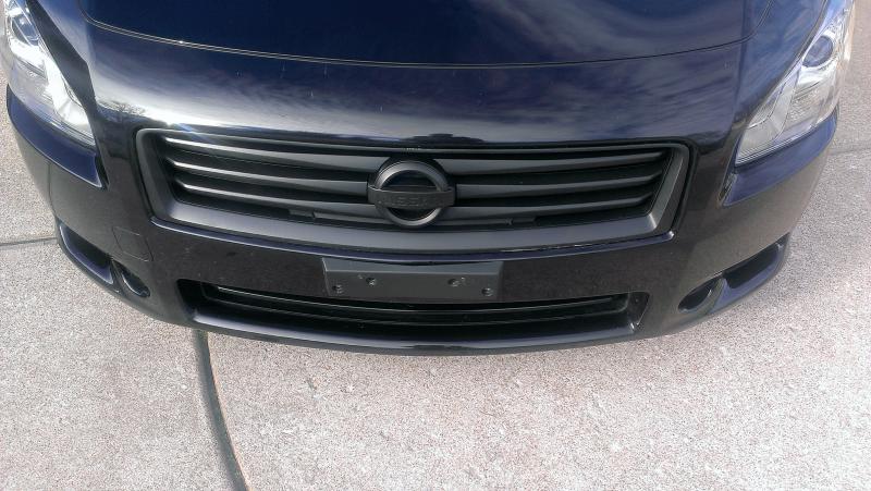

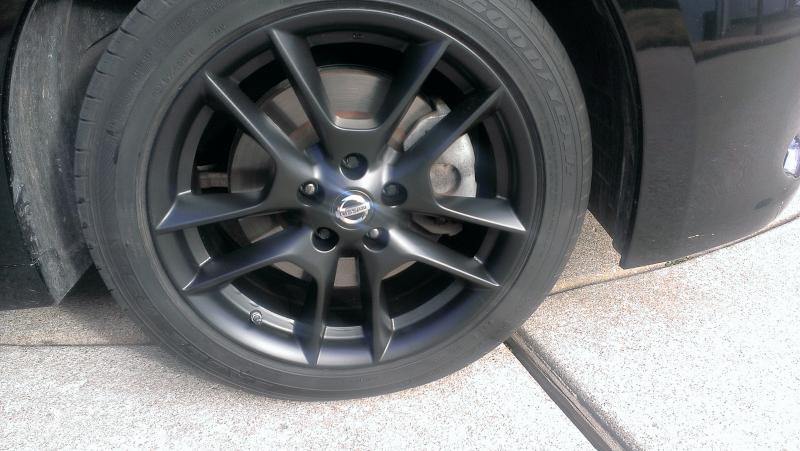

Plastic dipped my maxima this weekend, did the grill, the back Nissan symbol, and the rims. I think it turned out pretty good. I ended up using about 6 cans and about three coats on each rim and other pieces.

I would've done the chrome above the rear license plate too.

Thanks all, I want to do the back chrome strip but did it four damn times and it never took like I wanted it to. I want to find out how to remove it then do it again, then put back on the car. This stuff is easy as hell to work with and very forgiving also. I think it totally changed the look of the car.

Very easy to remove, open trunk, remove liner, disconnect wire for trunk release, you'll see three little bolts, remove those then use a pair of pliers to squeeze the Orange tabs and pull it off

Thanks all, I have about three coats on the rims and want to put one more full coat then the gloss on there and be done with it.
