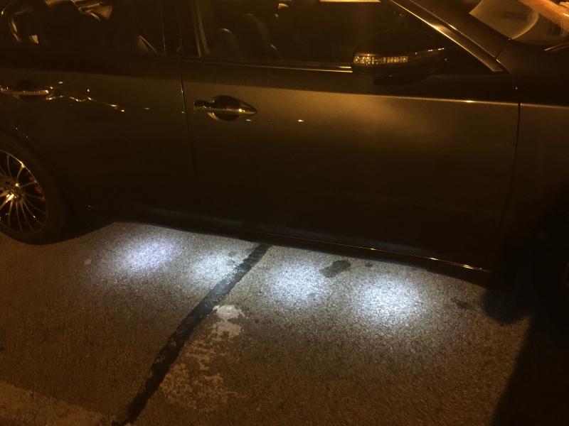

I added the side skirt lighting and the lighted kick plate through the dealer. I like the lighting effect. Working on adding DRL lights.
Any suggestions on running wires through the power distribution box? I'm thinking of drilling a small hole... pass the wires through and seal with silicone ....

I would recommend using an add-a-fuse and tapping into the fuel pump relay (15A I believe) through the engine fuse box. This way the DRLs are on when the car is on, and off when the car is off. Simple and can be removed without any trace, and the plus side that it is fused for extra protection.

I simply drilled a little hole and got grommet from Lowes. Also bought an add a fuse and tapped into the windshield washer fluid fuse. It is tight in there so I remember modifying the add a fuse allowing it to bend 90 degrees.
