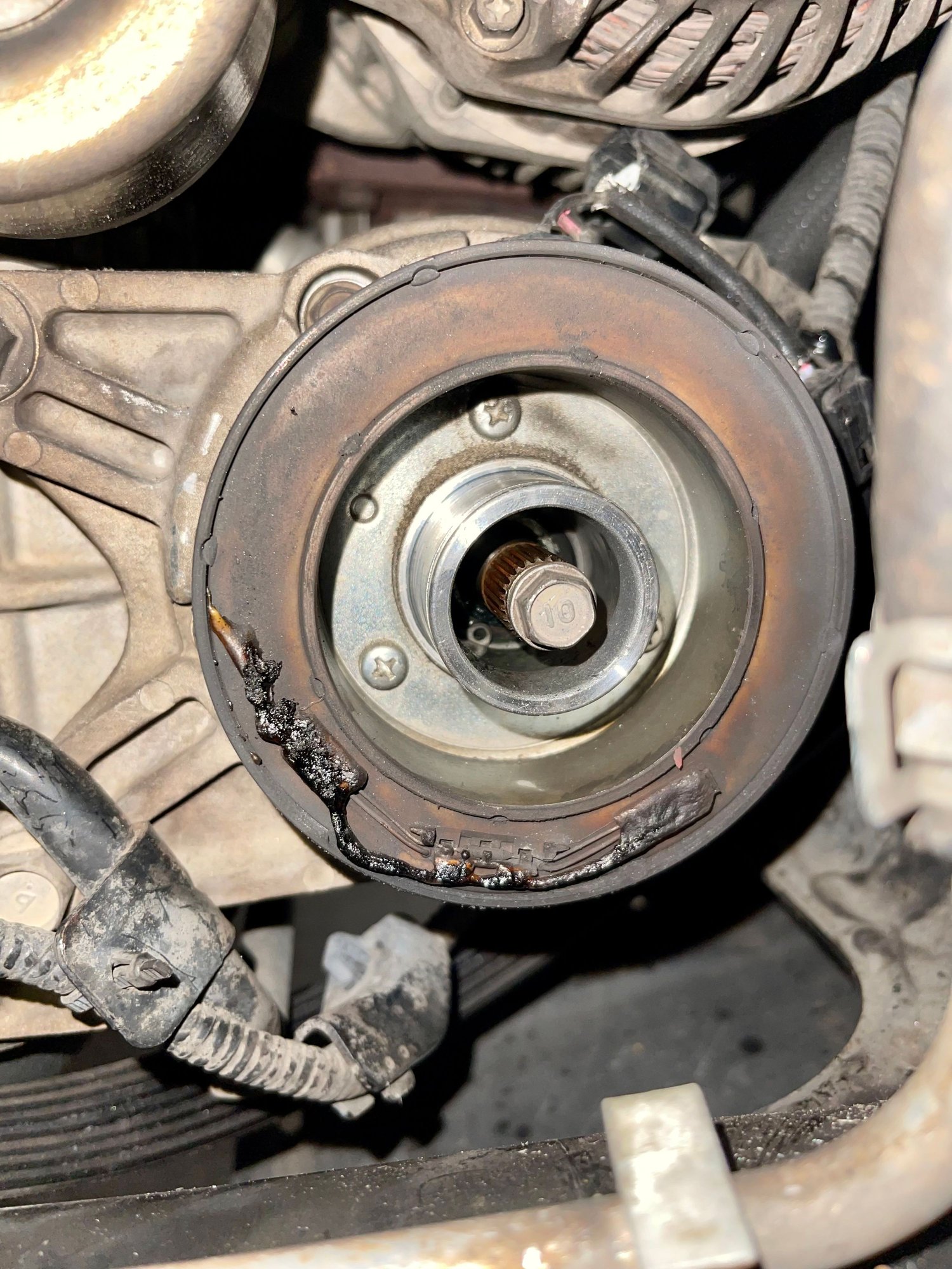

This worked for me
[QUOTE=13Maximasv;9045158]I'm guessing you turned the temp down to 60 and are still getting hot air ?
My AC was working great in the 100 degree south Ga heat and stopped blowing cold suddenly. It happened when I left a store and mashed on it pretty good and the ac went hot. After hours of reading online about everyone else’s issues, I decided to order a replacement clutch assembly on Amazon for around $50. Turns out it was all I needed. See attached picture as to why the clutch stopped. The relay/fuse whatever burns up under the cover

B3AST:
THANK YOU for that, I really appreciate you taking the time. It sounds like exactly what happened to me and your explanation makes sense. I'm going to try it and report back.
