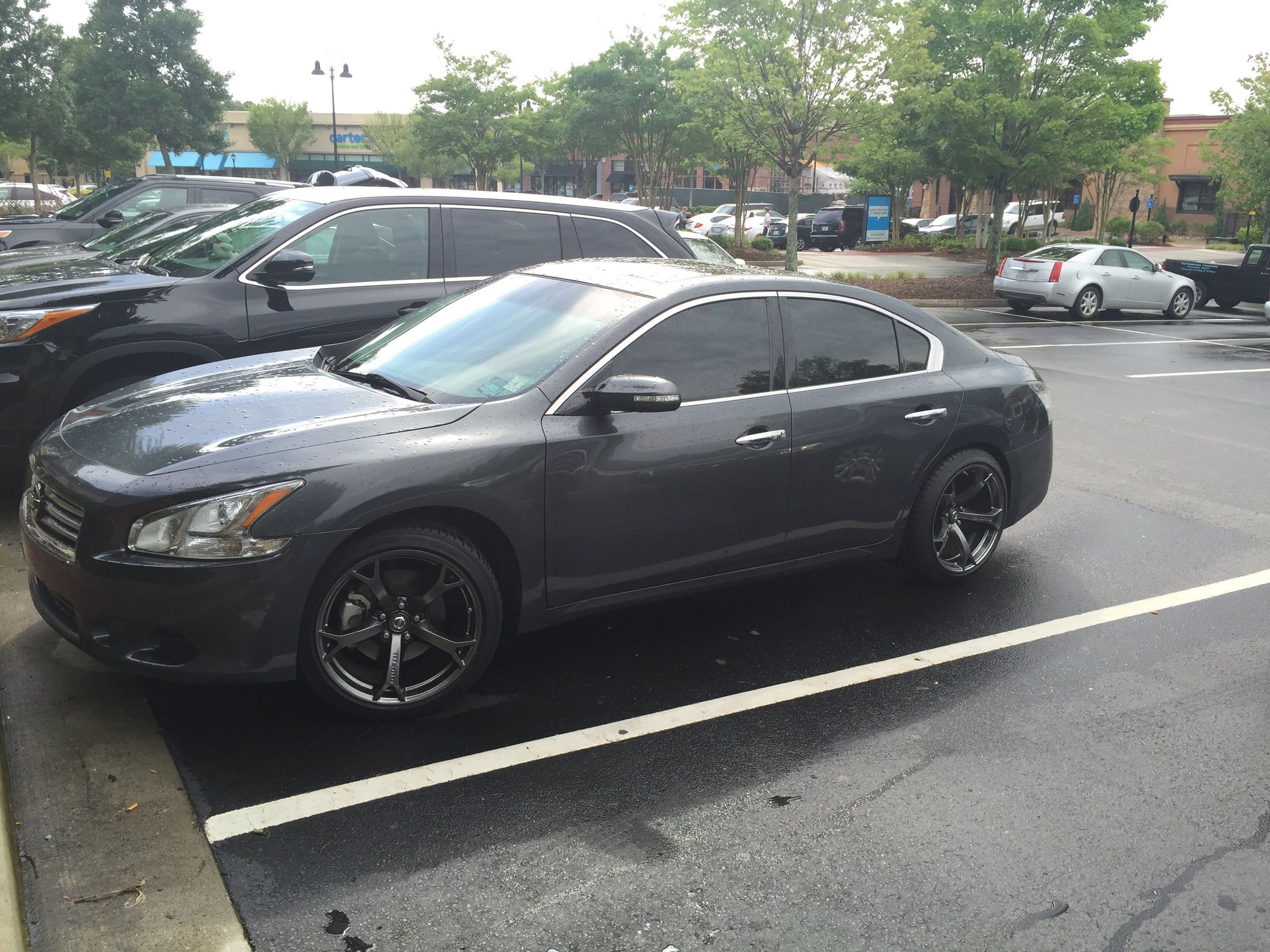

Installed!

Moar!
First mod to the car, not a bad start.

Is that on stock suspension or springs?

sh*t looks tough! Those are my favorite stock wheels along with the M56 20s.
Looks stock or the springs haven't completely settled yet, looks good though....love those rims

Stock springs. Eibachs on the way but having trouble with the fender rolling aspect here in Georgia
