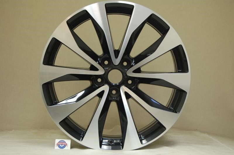

Those look nice. I like the first ones. Has anyone thought about adding the SR wheels from the 2016 Max to our 7th gen? Someone was willing to sell me theirs for a steal but I don't know how they would look on a Pearl White 7th Gen. I don't believe his are chrome.
I would not, too narrow and too small of a diameter for my taste.

not too big of a fan of those, looking really into the ones i posted, only reason i added the 3rd one half way down was my concern in rubbing when turning and of i did 20x10, how do i get them without poking out.

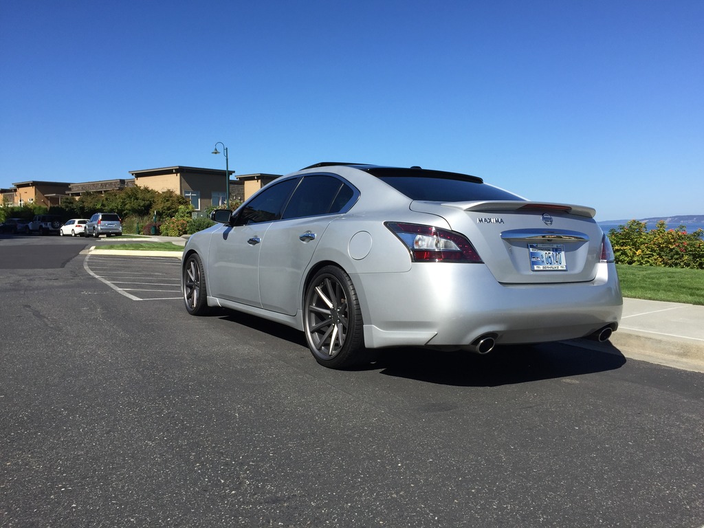

From: Seattle, WA
20x9 in front, 20x10.5 in the rear. No rubbing issues:
You appear to be running a 245/35 on a 9, same as my current setup. My question is will a 20x10 on 40mm and 275/30 not rub up front even at full compression and cornering.
