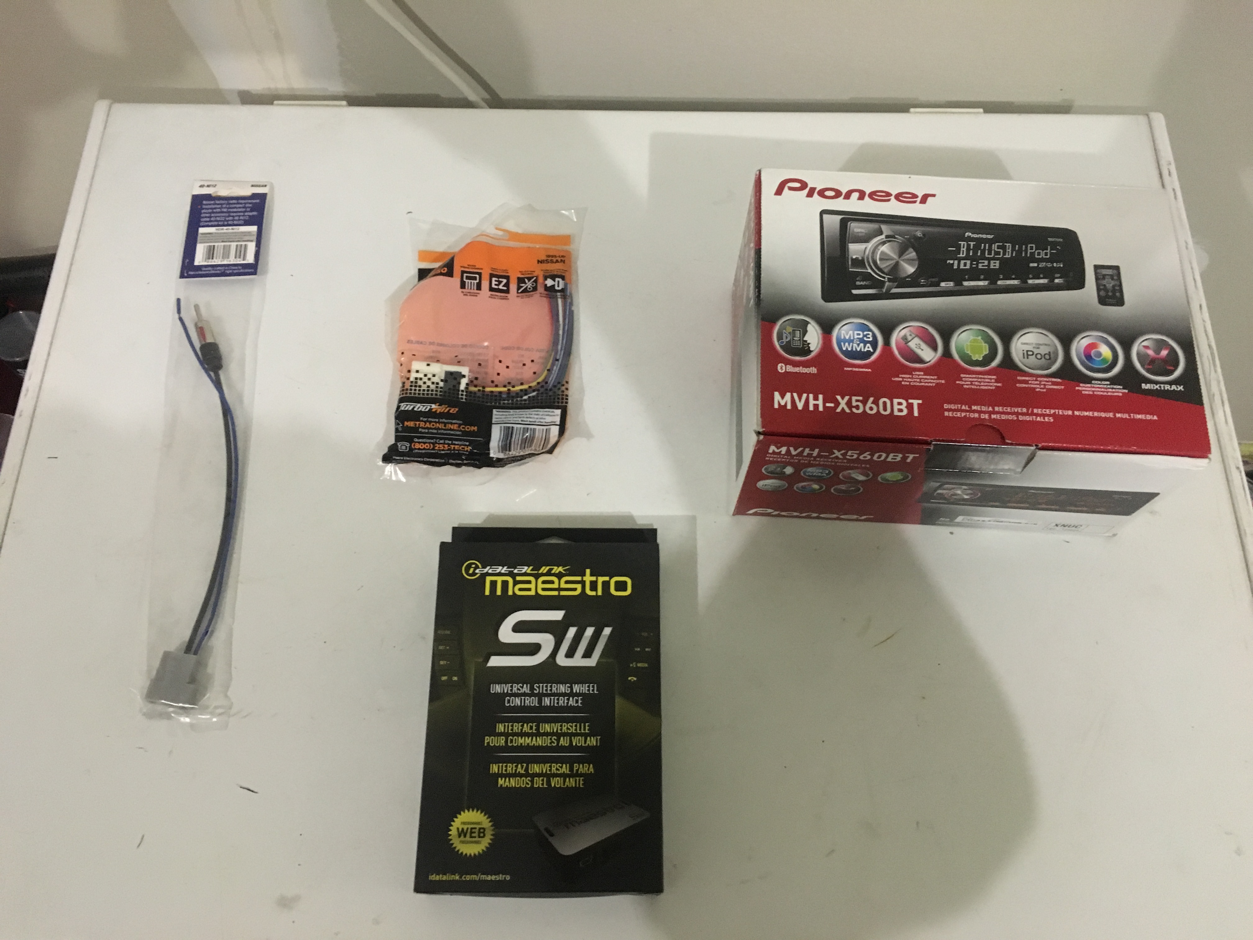

I'm new to this thread. I have a 2014 I bought with 8K miles on it about three weeks ago. This weekend I had a Pioneer mvh-x560 bt installed. I also had a steering wheel control interface so that I can turn the volume, source, and song/radio channel. The call answer function is operational at this writing because the install guy said he was unsure where in the car (possibly somewhere in the back) hookup was for that option. At some point, I will let another install guy look at completing that part of the setup.

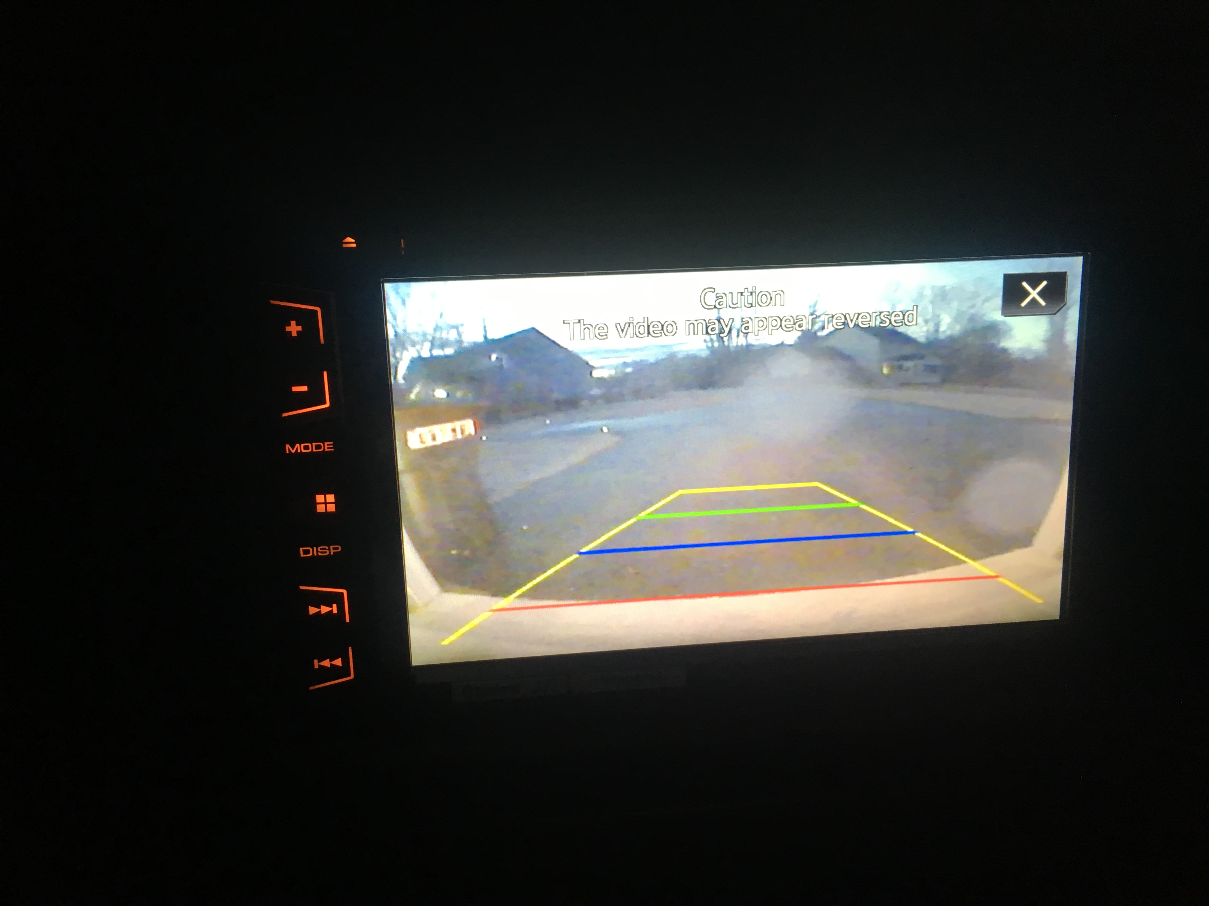

Install took about 3 hours at a local shop. I added a backup camera as well because I think it's a pretty good feature. I'm surprised the 2014 Maxima didn't come with it because my wife's 2014 Accord did.

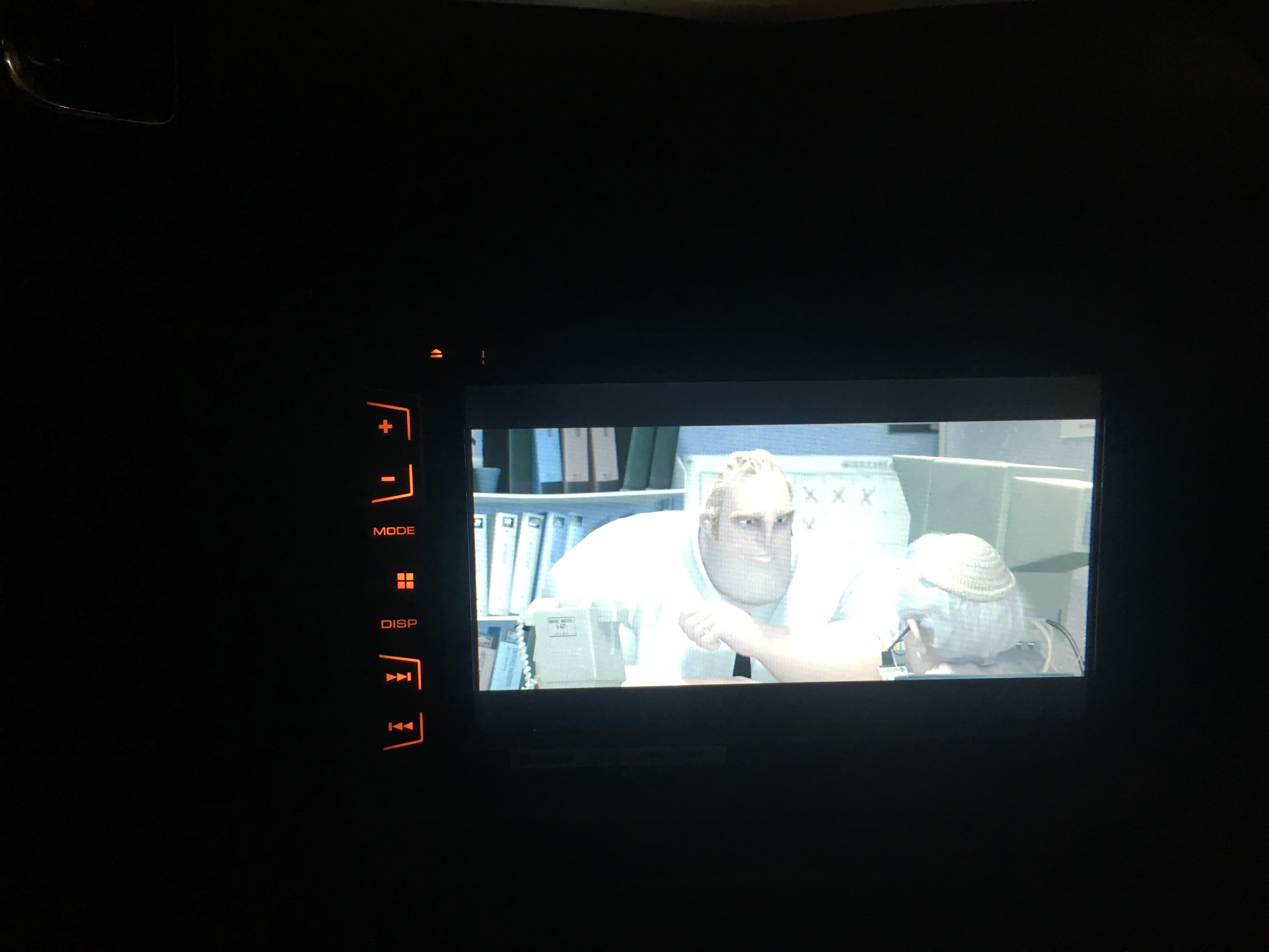

The 2700 is a good buy that plays DVDs and handles phone calls flawlessly. You can stream music from an I phone (I'm using an 6s) without any problems. The faceplate is NOT detachable. I think Pioneer's NEX 4700 model has a detachable faceplate. I honestly don't feel the need for one. If it gets that serious, I'll probably add a Viper alarm or something.

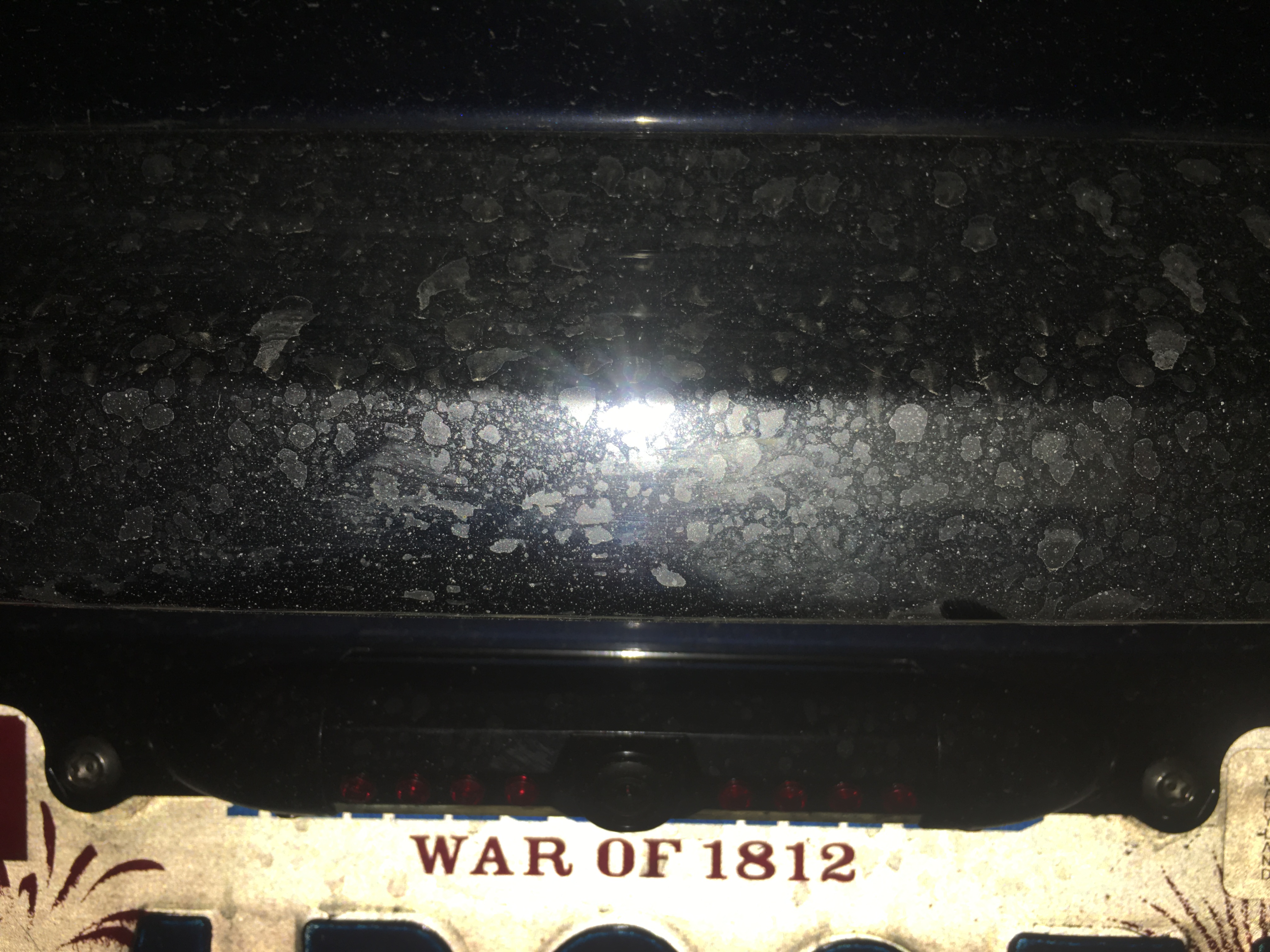

Im not sure what model backup camera it is because I didn't like the reviews the model at Best Buy had. Pioneer also makes a backup camera, but you have to mount it sort of at the "bottom" of the frame, and that can be an issue, especially with snow days. I think the license plate area is the best place for the backup camera, but some might disagree.

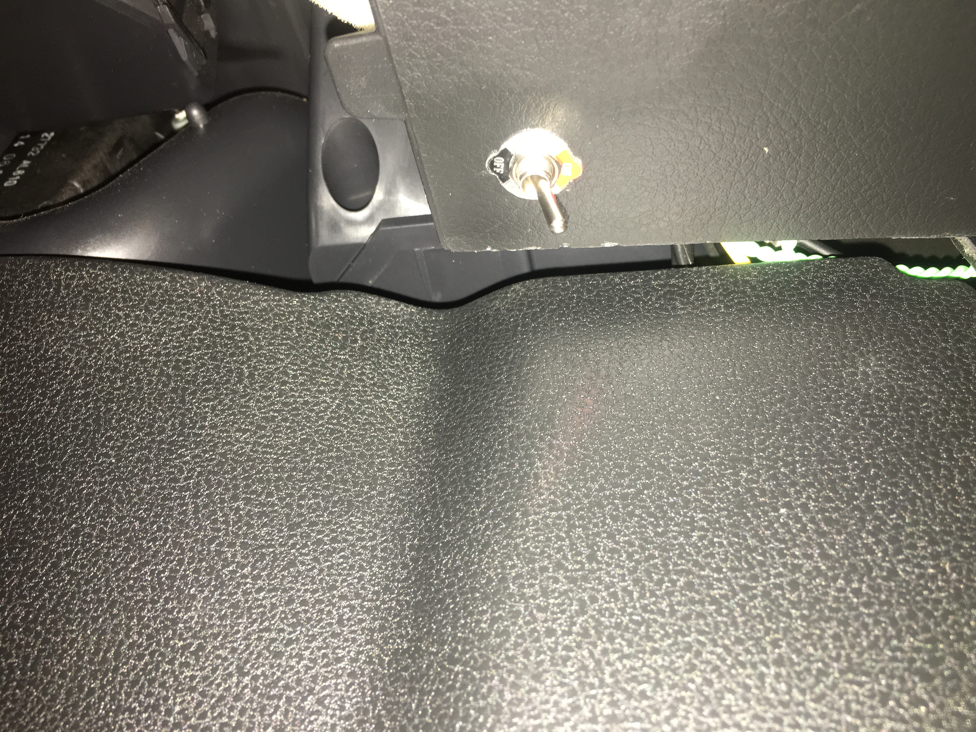

There's a switch (bypass) the install guy put in so that the DVD player can play while driving.
