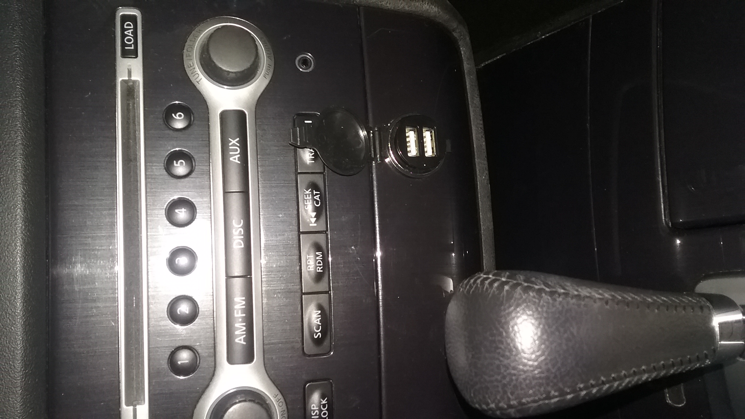

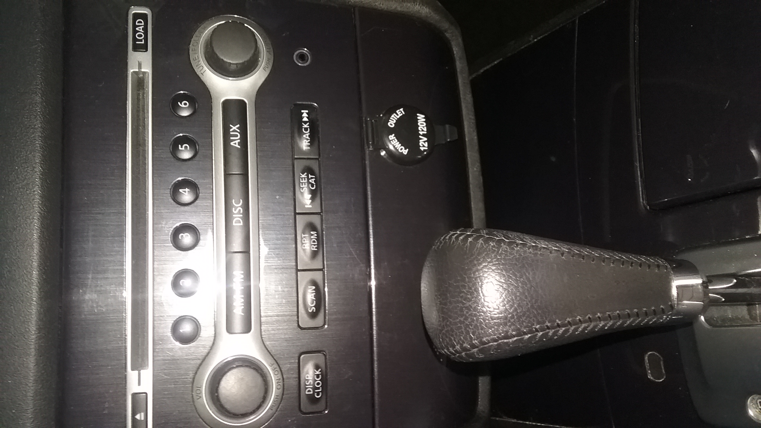

Mission Accomplished
I was finally able to install an additional 12v outlet that came with a USB insert. I bought two outlets and planned on installing both for a balanced look, however went with just one because, 1) I was lucky enough to drill the hole perfectly for the one and didn't want to push my luck, and 2) the second one would have been behind the shift ****.
No more digging every time I need to plug something in!
