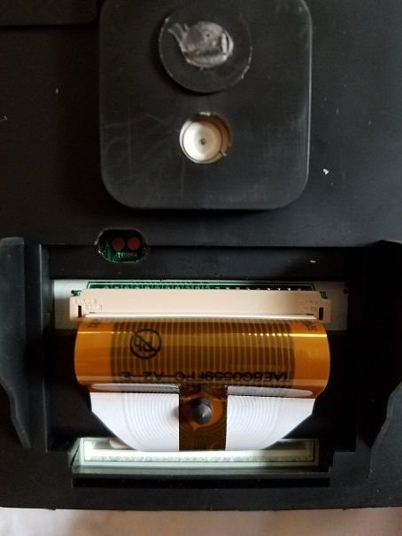

The information display on my 2014 recently stopped working I suspected a bad connection. I removed the gauge cluster and found the ribbon connector, located at the rear of the cluster, This ribbon connects the small LCD display to the cluster.
Because it is pretty cheap and flimsy this connector can come loose and cause the display to not work at all or not work properly. I just removed the plastic connector and reseated it and the ribbon cable. The display now works fine. I'm willing to bet this is the cause of the majority of the problems with this display. Removing the cluster is a surprisingly easy job. I think most people could do this repair in 30-60 minutes.
I would not be surprised if other Nissan vehicles such as the Altima have the same issue.

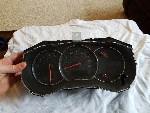

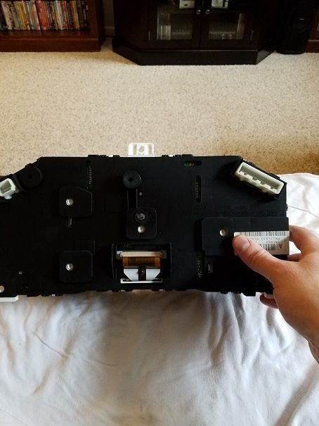

Well, we finally got some near-freezing temps on a sunny day that allowed me to be outside for a while. Nopike was correct on two fronts: the fix worked and the entire job took about 30 minutes. So, an absolutely huge thanks; you saved me at least $1,000! I should mention that, much to my disappointment, this fix did not work immediately; however, my Information Display came back online after about 30 minutes of driving. It could have something to do with how I placed the Information Display's ribbon cable (see below). Admittedly, I was a bit nervous before starting, but I think most anyone can tackle this job. As a reference, I’m handy, but have no experience with anything auto-related. Pictures are posted in the next post (the first and last pictures were taken just over a month apart). Below is a description of the steps I followed to complete the job.

8) Place a towel or t-shirt on top of the steering column to prevent scratches and remove the Combination Meter (15) [MWI-122]. There are three screws (bottom left, bottom right, top middle). I completely removed the Combination Meter by disconnecting both wire harnesses. I did the rest of the job inside the house.
8) On the back of the Combination Meter, identify gold ribbon cable for Information Center (bottom, middle). Using a needle-nose pliers, I removed the long, tan plastic piece holding ribbon cable. I then placed the ribbon cable back into position (there will be leeway left and right) and reinstalled the long, tan plastic piece that holds the ribbon cable.

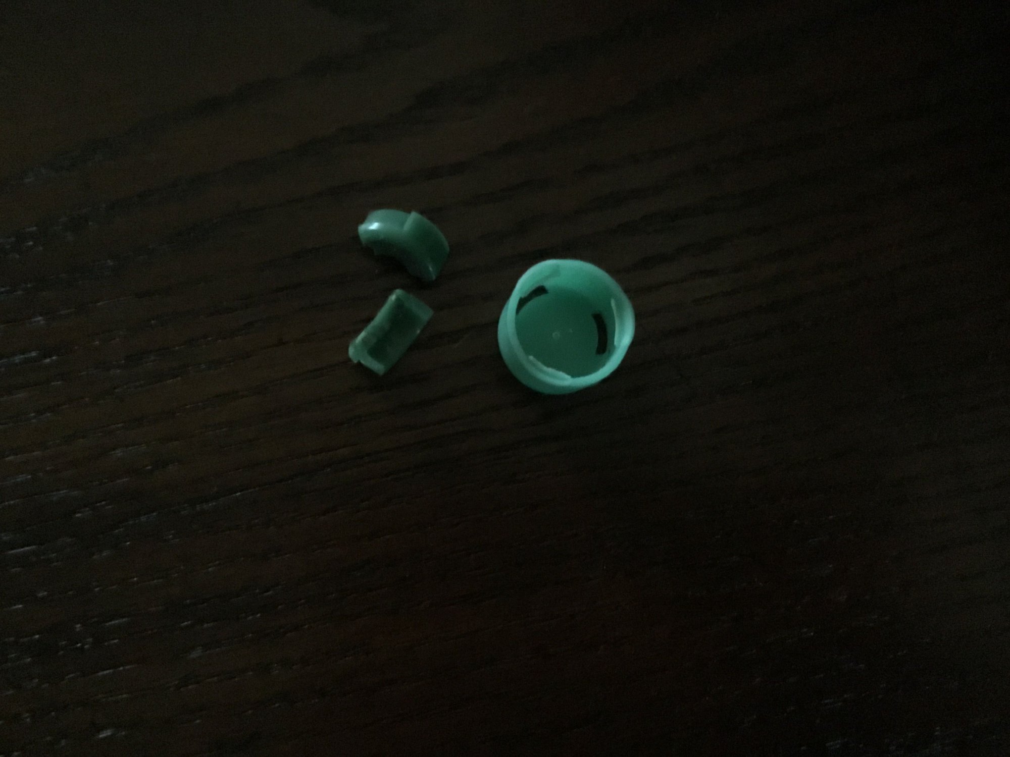

Nov 15, 2020 | 12:34 PM
I successfully completed this repair so add me to the list of grateful beneficiaries of this thread. However, when I started to reinstall the lower cover I noticed the pictured pieces of plastic laying on the cover. Does anyone know what they are?
the one that looks like a lid is about 1”. The other looks like maybe a keeper or clamp? I thought maybe from the aspiration hose, but I didn’t notice either of them when I took it apart, and nothing ever felt like it broke. Everything seems to work. Wondering if they are needed?
Nov 16, 2020 | 08:18 AM
Great question...when I did this repair about a year and a half ago, I had the same thing happen...just one "cap" though, not one plus some like you got. I looked all up under the wheel and couldn't figure out where it came from, and now obviously it's been some time with it gone and everything has worked 100%. Curious as well if someone can chime in who knows what this is.
