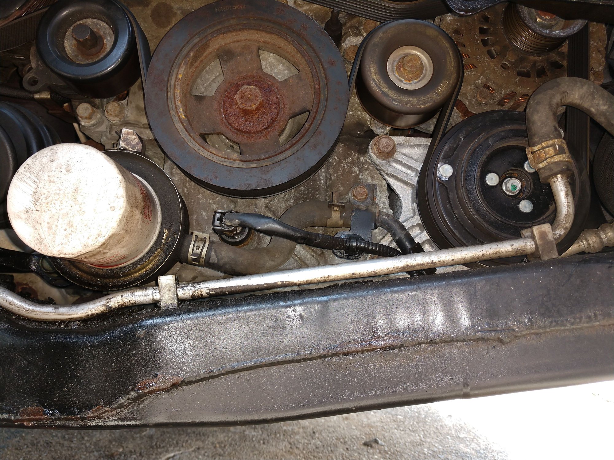

My 2011 maxima has a big Power steering leak. I pulled off the passenger wheel and it looks like the leak is coming from a bolt in a component, but I'm not sure what the component is. Any help is greatly appreciated.
Thanks!!
What is that part right behind the thin metal pipe? It looks like the leak is coming from the bolt in the center of that part.

You sure it’s not leaking from somewhere else and not just pooling up In That spot? I think the power steering is directly above that area so it might be leaking down onto that spot

To tell you the truth, the whole area was soaked, but when I started the car with a full tank of PS fluid it looked like it was coming from there.. it was bubbling/fizzing there.

That's a motor mount ...

Really? So I'm assuming the leak isn't coming from there lol... It really looks like it's coming from that area though, as it seemed pretty dry highee up closer to the pump.
What is that thing silver pipe in front of the motor mount?

I'm not a 7th Gen guy and I'm no way an aficionado related to those, but based on the routing and the material, I'm gonna say that looks very much like a high pressure power steering pump line.
Clean all visible and accessible portions of that line really well and wrap it in white paper towels and masking tape.
Run the car and turn the wheel from stop to stop a number of times.
Turn the car off, access the line and slowly unwrap the line looking for steering fluid.
You might have a pin-hole leak on the hard line.

I just had another chance to take a look at it, and it appears it is coming from the thin silver pipe as shown in the photos, and it looks like it happened due to it rubbing against the motor mount (shouldn't there be a bushing protecting that??)
I was looking online and it seems I may need this part: 49721-JA100 and I was just curious if anyone can confirm.

Just posting to say thanks for everyone's help. Job took me 30 minutes. Part costed $35. While comparing both parts, I noticed that the mounting bracket on my old pipe was installed upside down, causing the pipe to rub against another metal part. Attached is a pic of the old part with the hole.
