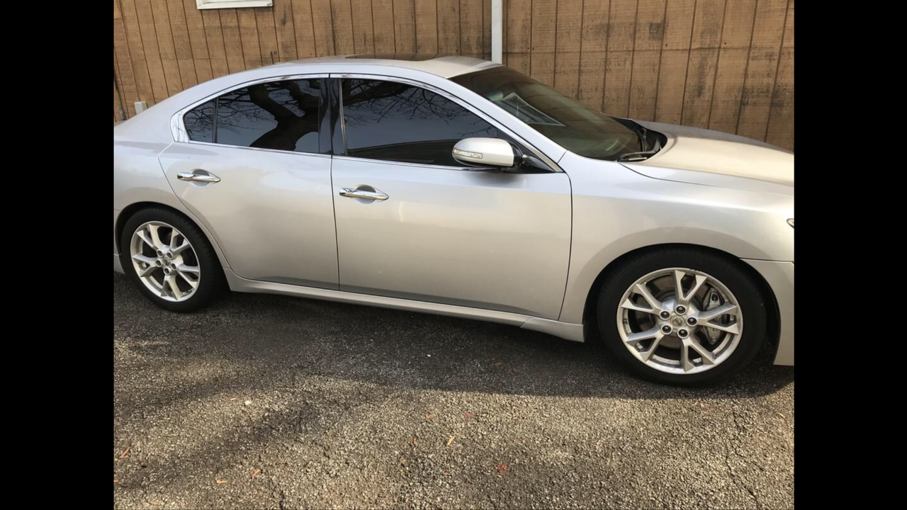

Big breaks with oem wheels
Thinking of upgrading my breaks, but still have oem wheels does anyone have a big break kit with oem wheels, do you have fitment issues?

My main purpose for them is I hear they last longer and perform better than regular breaks, wanted to make the upgrade if they last longer
