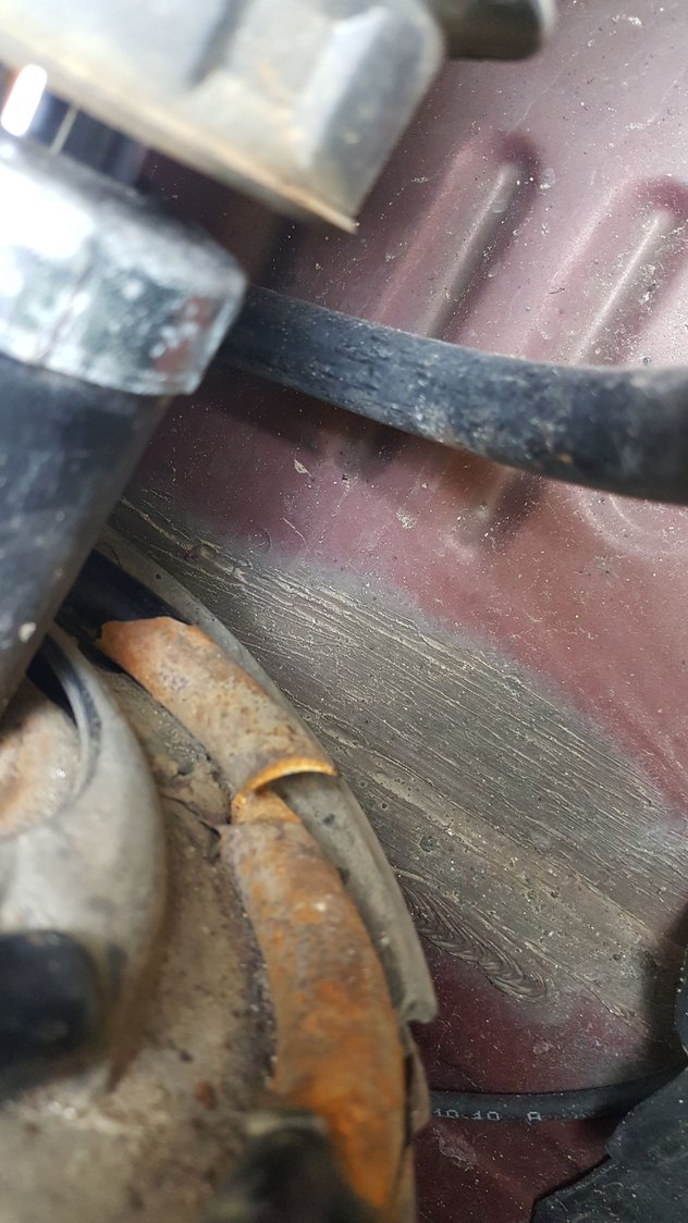

My right left front suspension coil spring just broke. My mechanic advised me that Gabriel and Monroe is crap. Any suggestions for a QUICK ASSEMBLY ( Strut with Spring Attached)
brand that will last 30K ??? My mechanic quoted me a price of $1200 for both Assemblies plus replacing the stabilizing bar.

Get OEM spring and value advantage strut from dealer. Most of aftermarket parts are Chinese crap.

Just spoke to my mechanic, he is using KYB, New to me. I checked on the internet and they are supplied on all new HONDA
SUV and sports vehicle. Independent ratings are very good. Im going with it

I had both front springs break about 2 month apart last year. I ended up getting a pair of Moog springs and Sachs struts with new nissan mounts and bumper stops.
Feels about the same as original.
Funny thing, both springs broke in the exact same spot. The first time happened while I was driving the car. I thought my tranny blew up due to amount of noise it made.

To the best of my knowledge, KYB doesn't make a front strut or front strut assembly for a 7th Gen

You are correct. KYB only has the rear shocks available for 7th Gen. My mechanic dupped me. He put on NAPA Proformer, made by GABRIEL. Not the best strut .
Interestingly, NAPA charges $150/ea. for the the Proformer, and $262.99 for the Monroe.
He advised me that the Proformer was made by KYB. Hopefully I'll get 50-60K miles out of these GABRIELS. Looking for a new mechanic.
