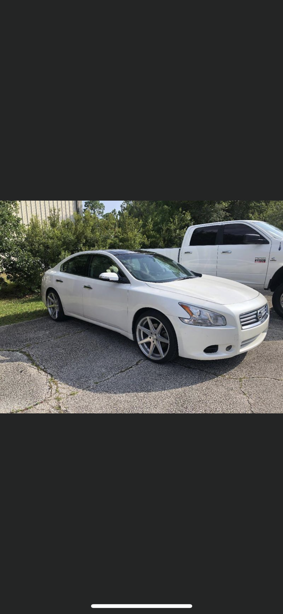

i run 20x10.5 with 45mm All around without issues
im not running any spacers atm
im dropped on RSR down springs

there is a little bit of negative camber with my setup
A little more in the rear than the front when I got this setup
nothing a set SPC Performance Rear Camber kit cant fix
