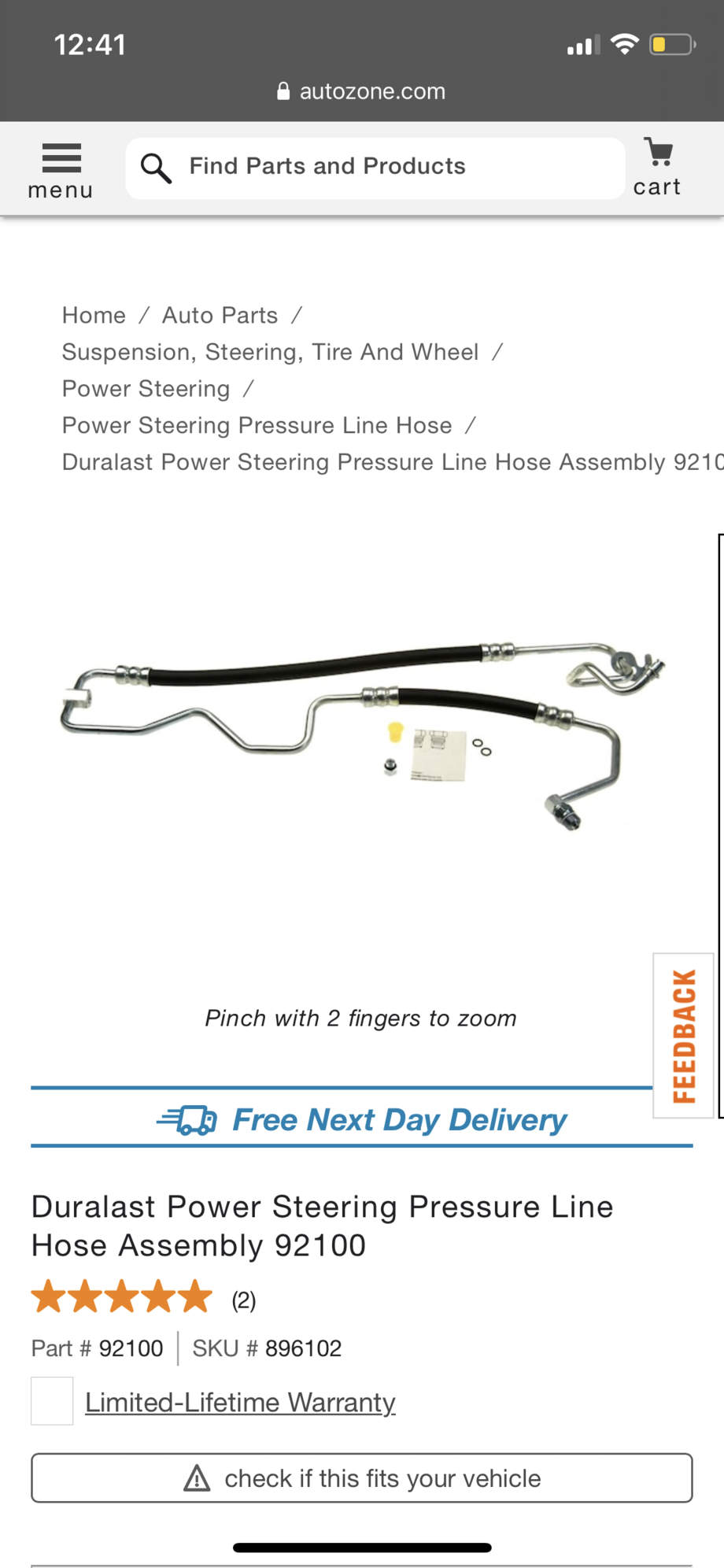

Can anyone please tell me what is them name of this line. It’s on the passenger side right near the axel. It’s leaking and just need to know the name so I can replace PLEASE and thanks

Looks like high pressure power steering line.

thanks for the reply but pulling up pics for the both the high pressure and the return line it kinda looks like the return. Just wanted confirm.

There's no way a power steering hose is serving as a pressure hose when it's got a pinch clamp at the hose-to-line joint.....so it's a return line most definitely.
I agree with you on that one! I didn't see the clamp previously, I focused on the hard line.
