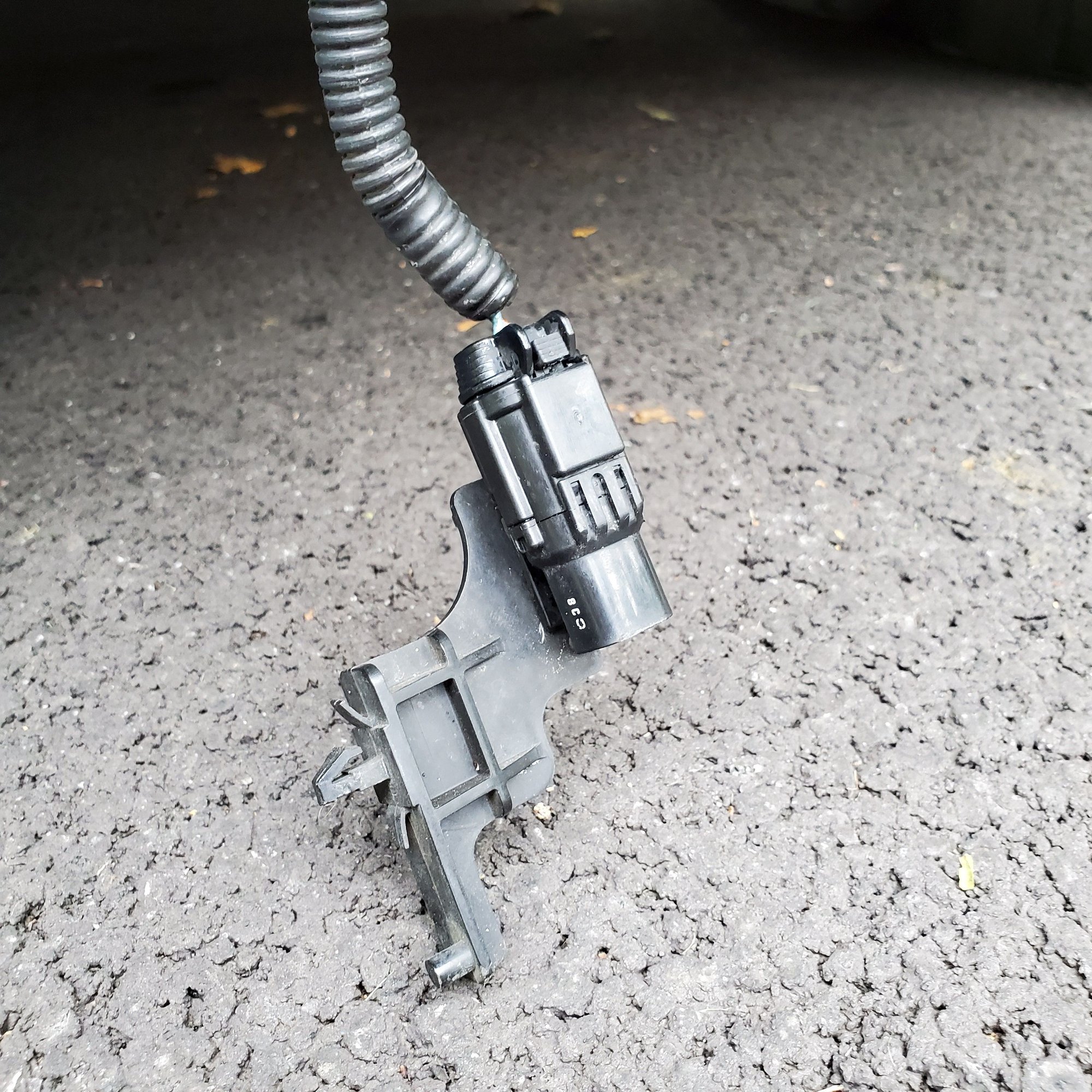

Hi All,
Had a leak in my top radiator hose and when I put car on ramps to investigate, I found this dangling from underneath the radiator, I'm guessing it's a sensor of some sort, and it looks to be just disengaged from it's resting place, but I can't seem to find where it attaches. Hopefully someone on here can help. Thanks!!

Ambient temp sensor

Thanks so much for the reply. Any idea, by chance, where it attaches? I have the service manual and can find it I'm sure, but any input would be greatly appreciated!

Right behind the bottom corner of the license plate drivers side and in front of the radiator. There is two holes there on the bottom of a horizional plastic piece. The wiring runs up the drivers side to get to this point.
