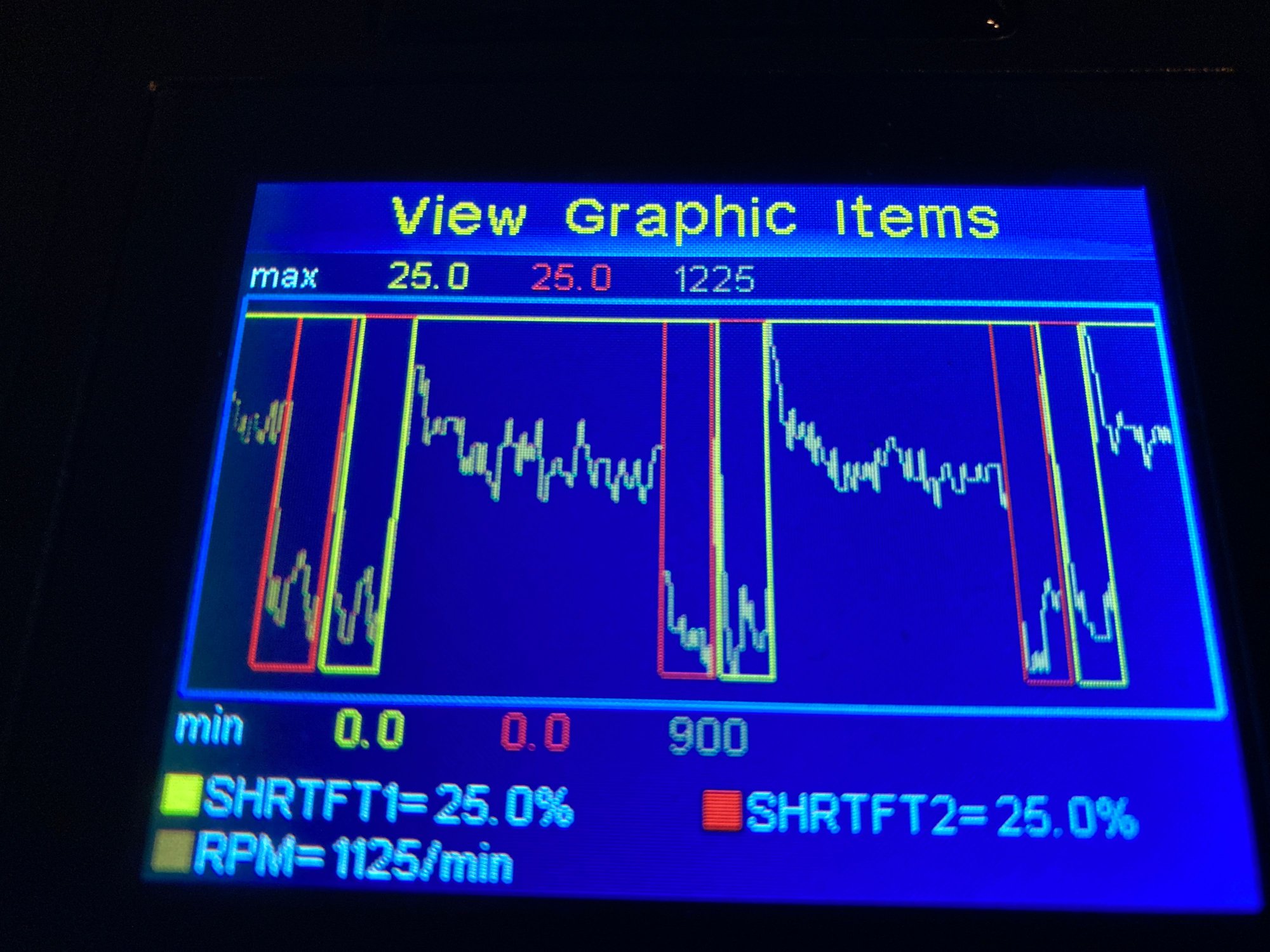

Here's a graph from the OBD II scanner:
Does this indicate that all four oxygen sensors need to be replaced?

Fuel Trims are off also
Also, the Short Term Fuel Trims for both banks are odd.
They switch from 25.0% when it is running well to 0.0% when it's running rough.

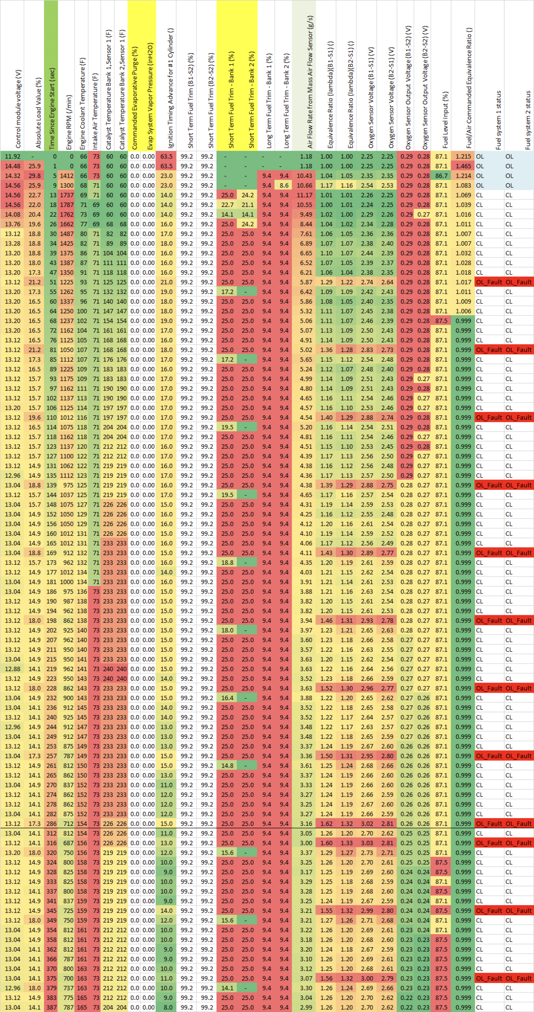

Old May 9, 2021 | 07:17 AM
kbezold's Avatar
Joined: May 2021
Voltages look fine
Here is a bit more data to look at. This is the OBDII data for about 6 minutes from a cold start:
I had just changed the MAF sensor about a year ago with one from AutoZone @ $132.
The first two lines are prior to even starting the engine and the MAF is reading 1.18g/s which seems very high.
You can also see the OL_Fault every 30 seconds or so in the last two columns.

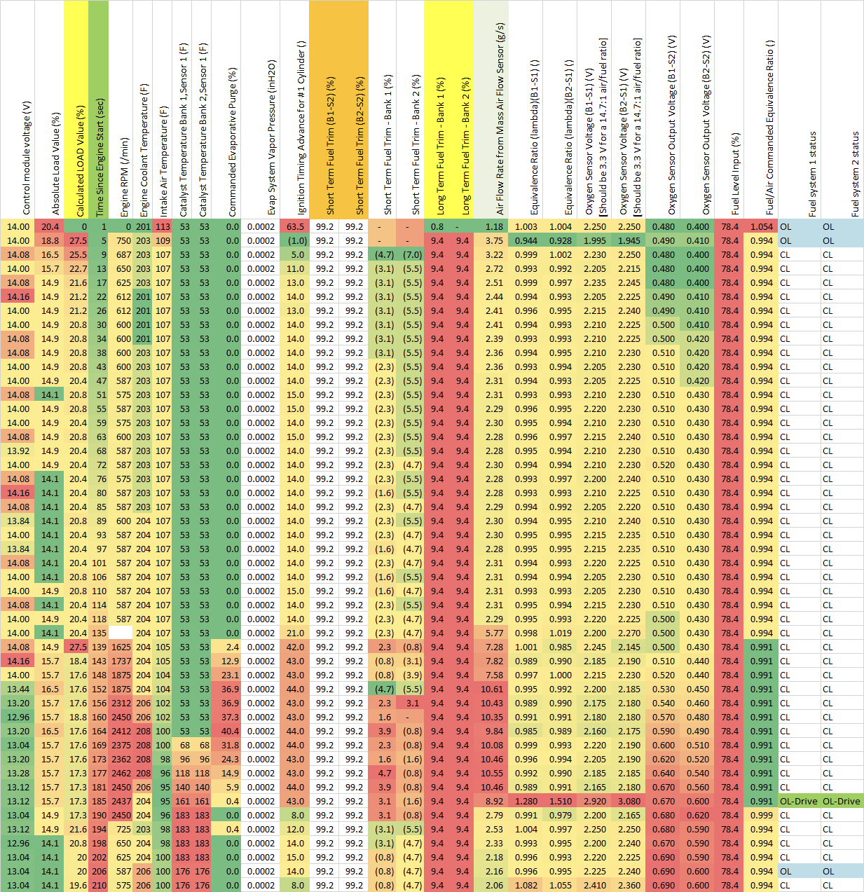

Changed the MAF
I had kept the original MAF sensor from last year when I changed it out. I put it back in and it's idling much better.
Here is a couple of minutes worth of warm data with a higher rev at the end.
It's still odd to me that:
  • the Long Term Fuel Trim stays at 9.4%
  • the Oxygen Sensor Voltages never get above 3.0v
It did solve all of the OL_Faults (every 30 seconds) and it is idling much smoother now.
I think the moral of the story is the aftermarket Mass Air Flow sensors are not good.
Thanks for the help.
