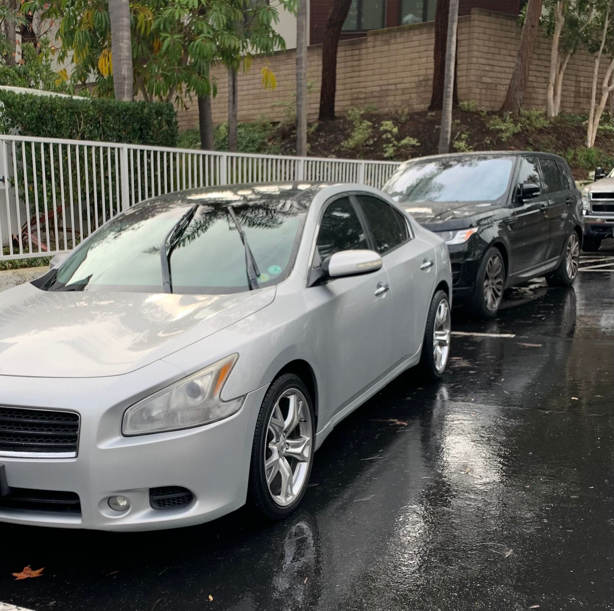

So I know they fit but I like the concave look of the rears for the Nismo 370z v1 wheels. I want to do all 4 with the rear which is a 10.5” wide at a 19” which would require like a 255 tire. Just want to see if anyone else did this and if it would rub on a stock suspension

I just put 370z wheels on my 2010 SV. 10.5 19" in the back fit fine. You can see the 275 width sticks out some in the back
Tire size
Rear: 275/35/19
Front: 245/40/19
