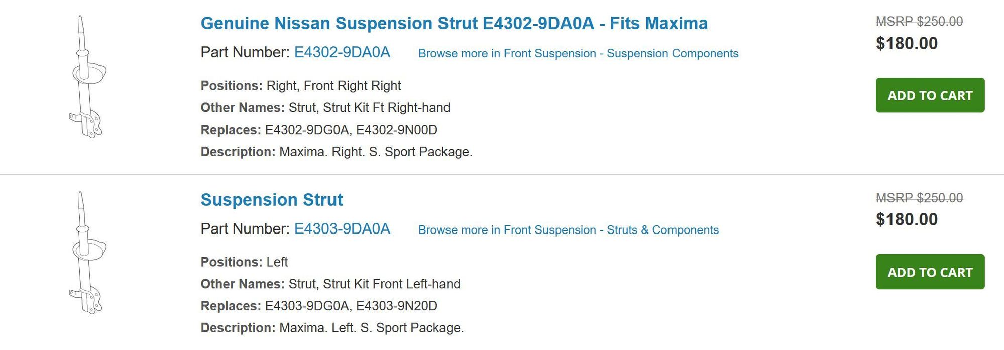

I’m having trouble finding struts that fit the sport package? Are the struts any different for sports package? Can someone send link with where to buy and which ones ! Thanks for the help!!

Hmm..a wee bit complicated. Looks like the Sport package factory numbers are E4302-9DA0A and E4303-9DA0A.
I have no idea what the aftermarket equivalent would be, say at https://www.rockauto.com/en/catalog/...ion,strut,7584
Hopefully someone has changed theirs out and can give you some direction which ones you can buy for the sport package.
https://www.courtesyparts.com/search?search_str=strut
