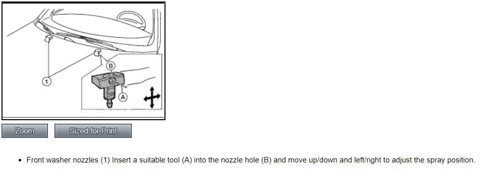

Does anyone know how to aim the washer nozzles on a 7th gen? Pushing a pin into the nozzle and moving it like in a ball and socked doesn't work. It looks like I could remove the plastic piece that surrounds the nozzle but it's cold and I don't want to break it.

Here is what Service Data Says...
