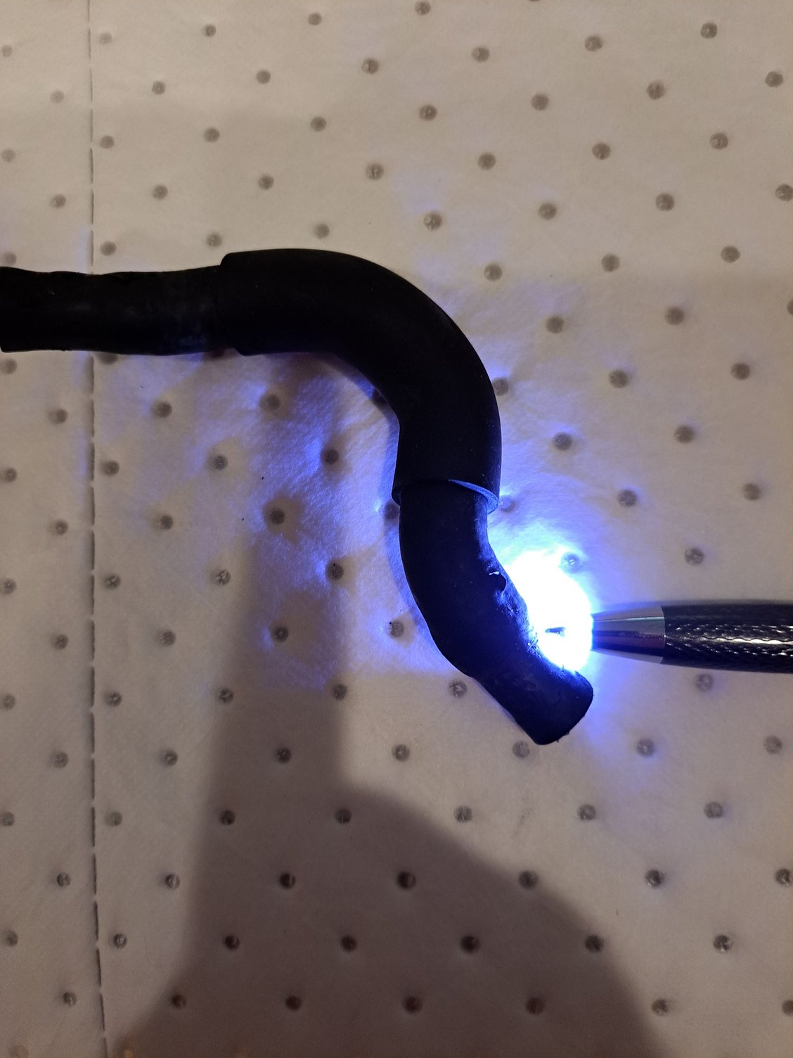

I can't seem to find a listing for the water hoses going to the throttle body on my maxima. Living in Florida where the AC runs all the time, I incorrectly assumed the wet spots on the ground was from ac condensate. While coming back from getting some new tires, I noticed the water temp gauge pegging so hard I thought it would bend the needle. Immediately pulled to a parking lot and found I had no coolant! Everything from around the radiator was dry (from what I could see in the parking lot) so jay walked across a 500-lane road (or so it seemed at the time) to get to a conveniently place NAPA and got some coolant to get me down the road to the house where I could examine it more closely. I found the coolant coming from the rear of the engine. An epiphany struck and I removed the airbox and hoses to look at the coolant lines to the throttle body. Sure enough, at the end of the hose nearest the driver side, where it connects to a water manifold, the hose was leaking and spraying toward the rear, down the cvt.
I would like to replace both. I had some high-pressure fuel line hosing laying around of the approx. inner diameter, and managed to fix the "leak" but, if possible, would like to order OEM. If anyone has the Part Numbers, I would be most appreciative if you could share!
Where the leak was
The leftmost hose I need to replace

Lt, here you go!! 14056JA10B and 14056JA11B are the 2 hoses you're looking for; they are $11 each at my local dealer.
