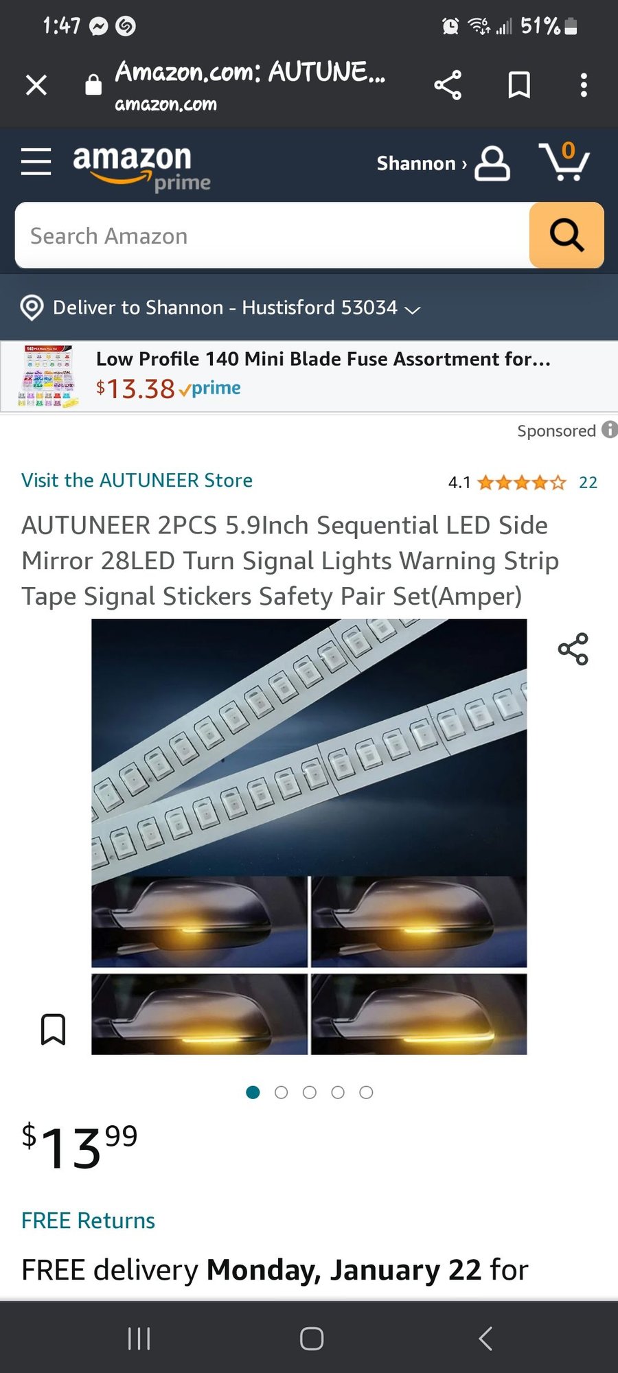

Any body change out the stock side mirror blinkers on a 2014 SV to sequential LEDs? I'm sure there's a video somewhere, just curious if there's anyone in here that's actually done it and if just the strips can be popped out and replaced.
I did, just redid them the other day. Not bad at all. You'll have to:
1) Pop off the mirror cover. Be very gentle as it's on there good and easy to chip/break.
2) Unscrew the blinker housing from the mirror. It's on the side where the mirror is. You may have to pop out the mirror but you might be able to reach it if you tilt the mirror all the way in.
3) Unplug and remove the blinker assembly. The lens should come right off. The whole thing is extremely fragile so be cautious.
4) Remove the lights. You just have to be aggressive and rip them out. They're LEDs on a strip board, you can just rip out the whole strip and the connector pins for the wiring.
5) Put in your sequential LED strip. You can either stick it to the housing with double sided 3M tape or just let it rest there, there's not much space for it to move around. I think it's about 6 inches long. Any sequential strip with a positive & negative wire will work.
6) Feed the wires through the hole where the connector pins were. The sequence goes from the wires outward so you want the wire side close to the hole.
7) Cut off the connector on the wiring harness.
8) Connect sequential wires to the vehicle wiring. Solder, splice, etc. Pink to black and orange to red. Check to see if it works, I would just twist the wires together, check, then secure the connection.
9) Reassemble. You can use double sided tape to keep the housing together. Don't screw the housing in too tight as it could break. Ask me how I know.
10) Enjoy your extra 5 horsepower.
I also used some tint film to tint the lens so the LEDs are less visible. They are very bright, much brighter than factory, so don't be afraid to go dark.

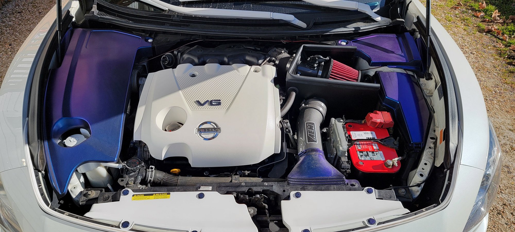

Bumper duct is useless now with AEM cold air intake lol. Powder coated my wiper arms Pearl at work Lip splitter, front lip, skirts, canards, 8k LEDs in all my lights, RBGW side markers, RBGW/ multi modes LED hood strip, Nissan Logo courtesy lights in all doors, blue LEDs in all interior lights, white plastic engine cover, blue/purple color shift on the other 3 pieces, billet upper and lower grille with Nismo badge, carbon fiber Nismo badge on trunk, Nismo side mirror carbon fiber eyebrows.

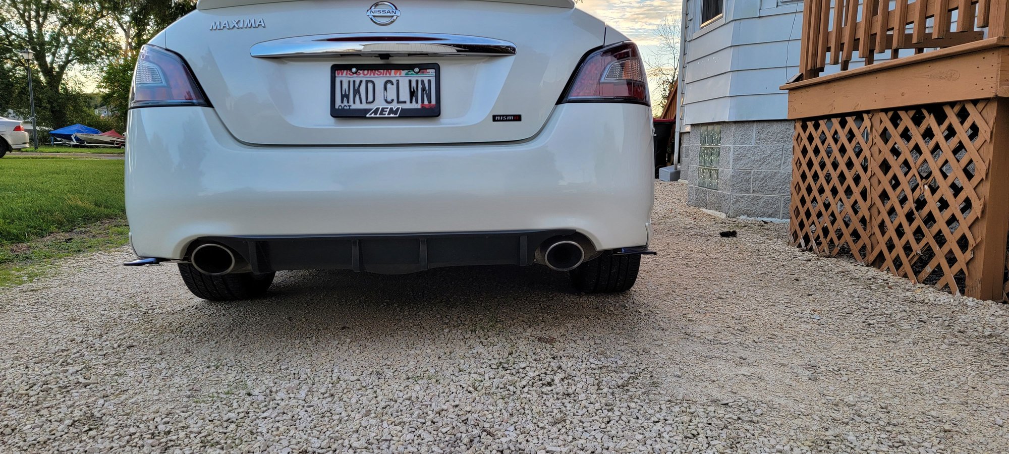

Rear diffuser.

That first one is what I have on my car right now, but you have to hardwire it. Some of the LEDs went out after maybe a year and a half, I just redid it a few weeks ago with the same strips (they had sent me two sets, the first one wasn’t the length I ordered. But I used them to redo it, just folded the strip in half.)
The one I linked is a plug and play housing and has a smoked lens option. No cutting/splicing/fabbing needed. I would do that if I were you, that’s what I will do if the LEDs in this one go out again.
