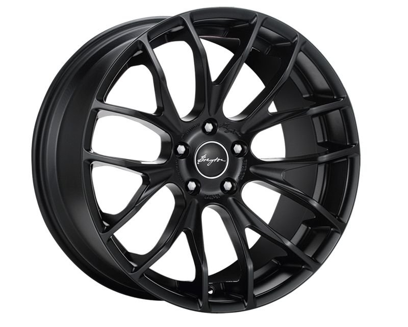

I really like the looks of these Breyton GTS 19's - Can anyone tell me if they'll work on the Platinum Max?
http://www.horsepowerfreaks.com/-p-1...T9kaAsgn8P8HAQ
BREYTON RACE GTS WHEELS 19X8.5 5X120 +30[50851930211117B]

Aslong as the bolt pattern is 5x114.3 hub bored to 66.1. But spending money like that they should throw in a set of hub centric rings for you. I would stay in the +32/+43ET range.
If they don't throw in the rings for you you can get them at Discount Tire for no more than $10.

Awesome - Thanks for the quick reply. Going to grab set of winter tires for my stocks and then probably grab these for next summer. I think they'll look nice on my pearl white Max.
