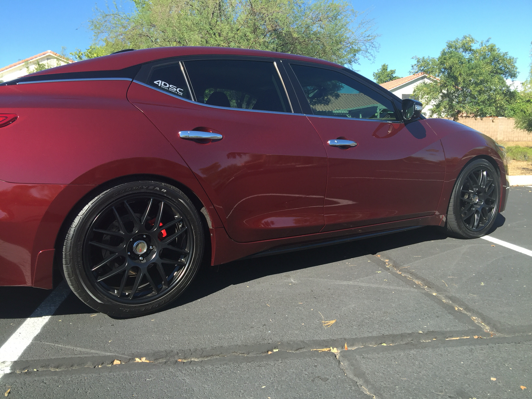

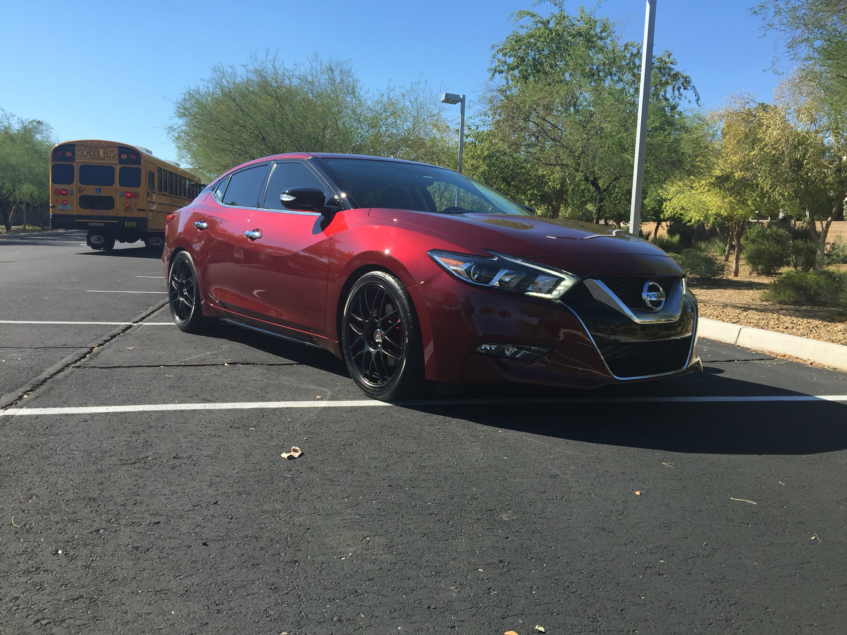

Here is my lower to 😀
Attached Thumbnails Correct Eibach part number?-photo360.jpg   Correct Eibach part number?-photo830.jpg

You're running RsR 7gen springs??

Yes and brembo brake rotors,stillen pulley and k&n short ram the harders part was the pulley because there is ony one belt you can use in is hard to found .

looks great.. what are the size of the wheels ? offset? any rubbing?

Am running 19/8.5 offset don't remember but no rubbing they set flash on the fenders am running 19s because I want to keep the same tire brand the tires on the sr are top of the line.
