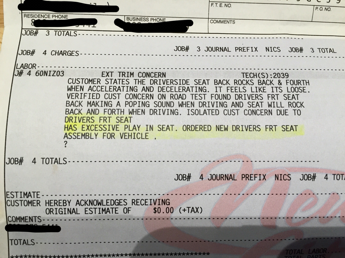

I hope this helps, this is the paperwork I got from my dealership regarding the problem and diagnosis for my front seat

Thank you for this information. Would appreciate any follow up on the actual repair/replacement and your assessment plus any paper conformation.

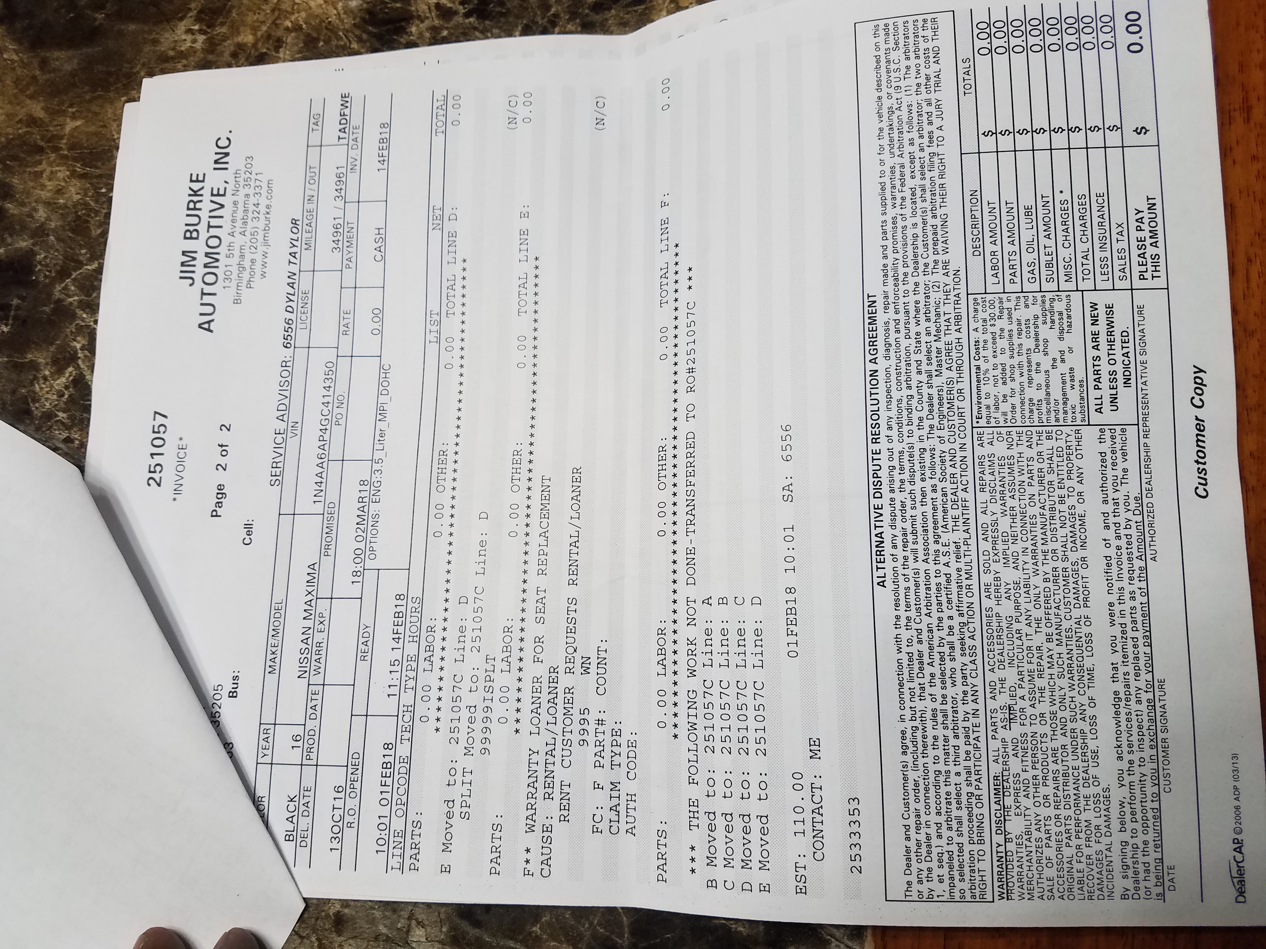

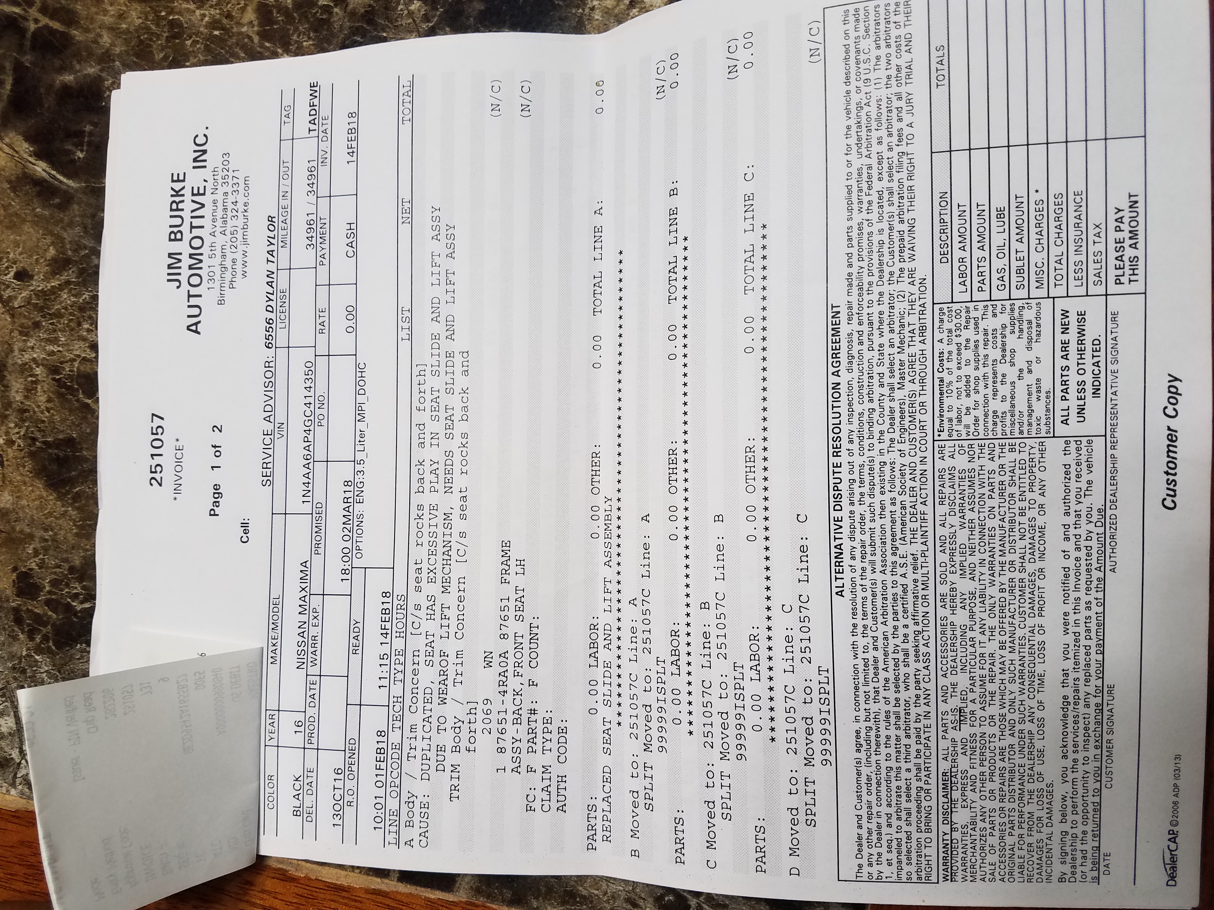

Old Feb 15, 2018 | 08:32 AM
MaxandAlt's Avatar
Joined: Mar 2011
Posts: 38
From: Birmingham, AL.
Old seat was replaced with a new seat by the dealership. No more rocking chair!!

I believe I was the first poster to recognize this problem. Purchased my 7/14/2015 brought in in 3 days later and complained of the problem. They looked at it and checked another new Maxima and stated that it is the same in the other car so it is normal. Been living with it but haven't noticed it lately. The position changing between my wife and myself may have an effect.

Yes, it will be covered under the bumper to bumper.
