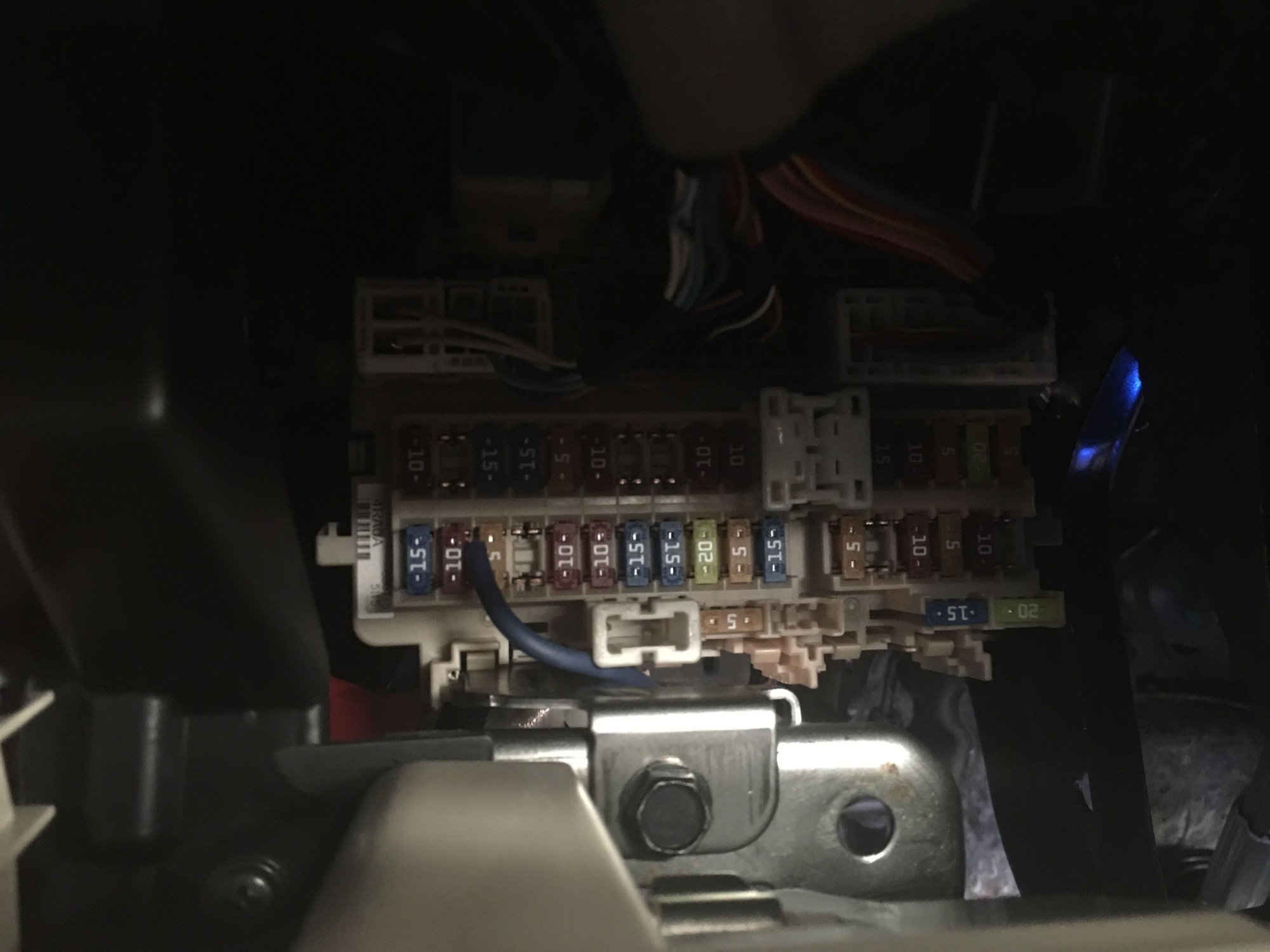

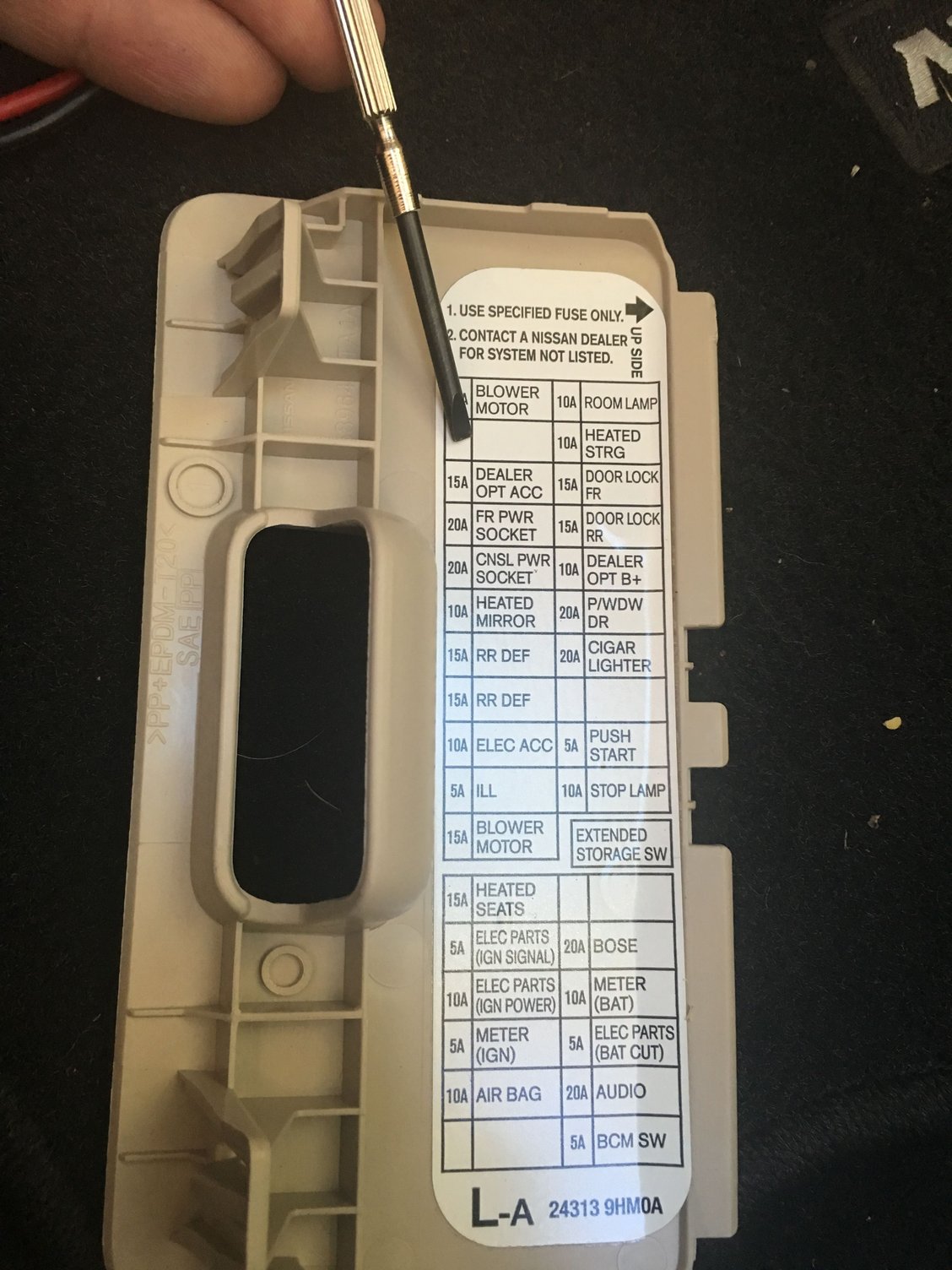

I had issues with the other one so I thought I would post this one to help out. Found a empty fuse location on the driver side and plugged a spare fuse in it. So far it was easy and appears to be working great.
Turns on and off with the Ignition and is a full 12 volts.
