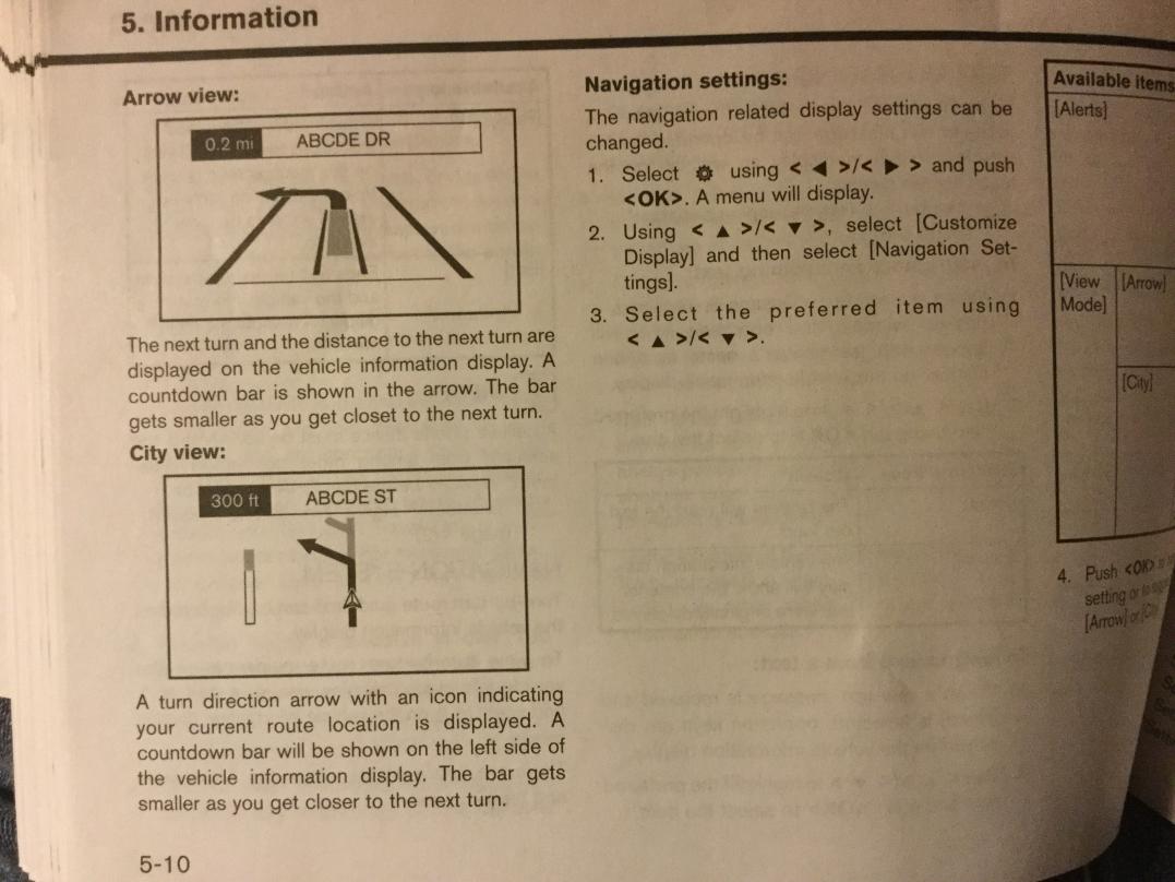

As for the city vs. arrow, in case anyone else is wondering, I found some info on-line from a Murano manual, so see the attached image, if needed.

That was a good find in the Murano manual. The 'arrow' view is supposed to represent the view of the road ahead as seen from the driver's seat. The edges of the road are shown growing closer together as the roadway fades into the distance. This is the generally preferred view when driving outside of towns and cities. 'The 'city' view is supposed to represent the view from overhead, as if in a helicopter. It shows the street pattern as it would be on a street map, and is the generally preferred view when driving thru downtown areas.
These differing views are a matter of preference. My wife prefers the 'arrow' view all the time, while I prefer the 'city' view all the time. My preference is influenced by my cartographic nature, and my 68 year hobby of collecting maps and drawing maps. I am very happy we have this choice in our Maxima.
