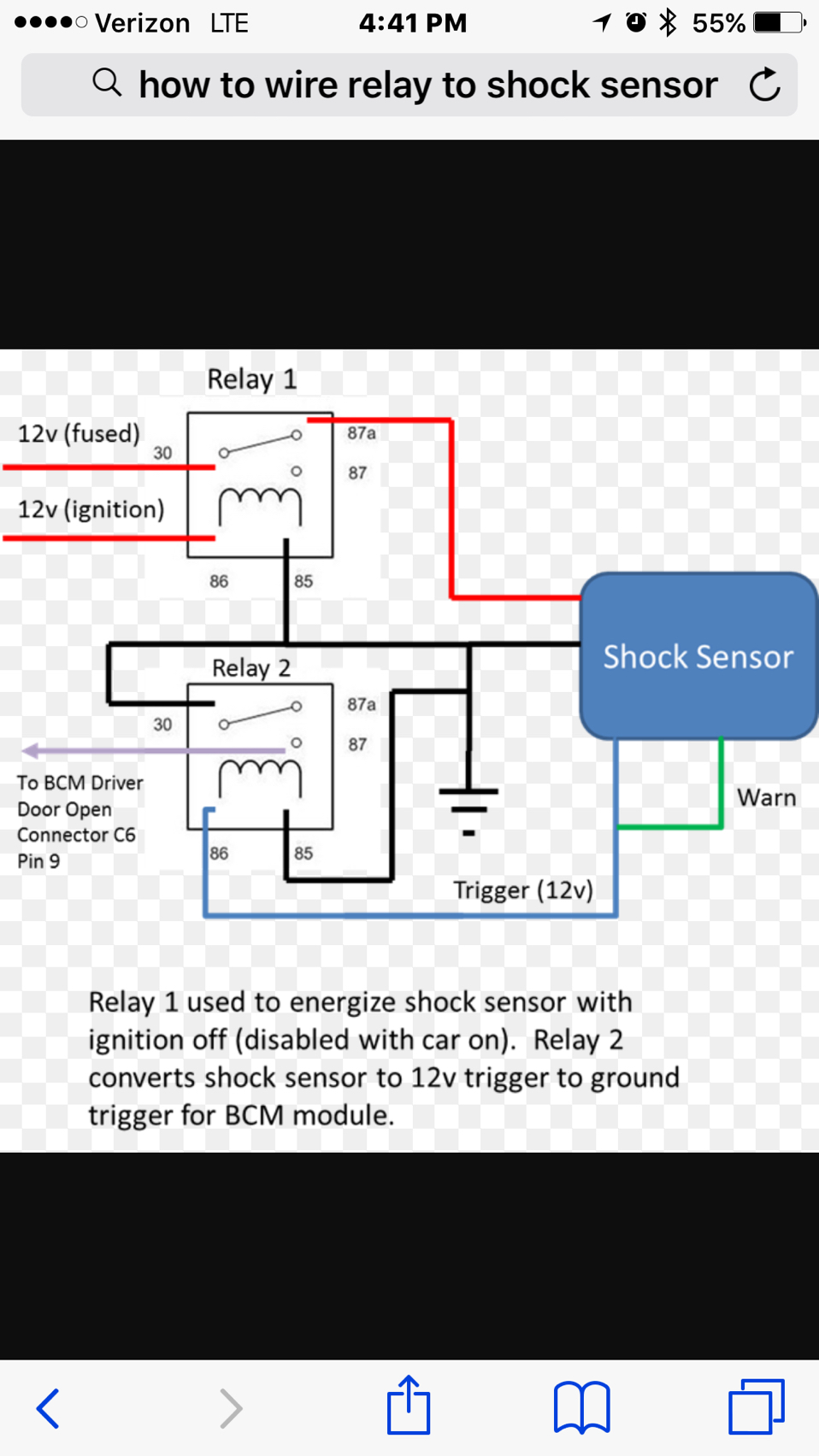

Is just a regular relay for lights you can get one at any auto part store hope that will help you.Installing a shock sensor to the factory alarm-photo133.jpg

Installing a shock sensor to the factory alarm-photo187.jpgClick image for larger version

Is just a regular relay for lights you can get one at any auto part store hope that will help you.Attachment 9918
