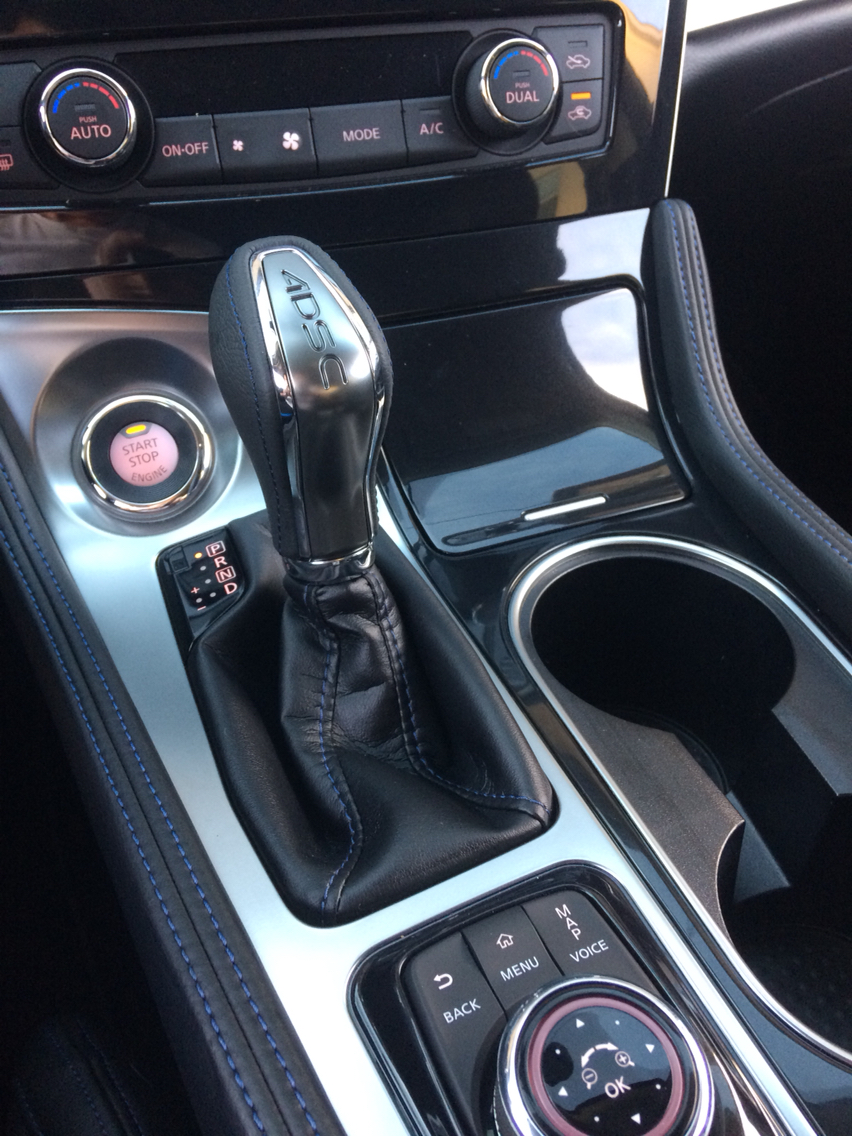

Installed, only issue I had was getting the shift boot back in place. Thanks for the help!
It is way easier to do when you put the car in neutral!
forgot about that tip!

Looks good, I have not found one that I can afford! They are a little pricey (especially with all of the other things I want to do to the car!)
