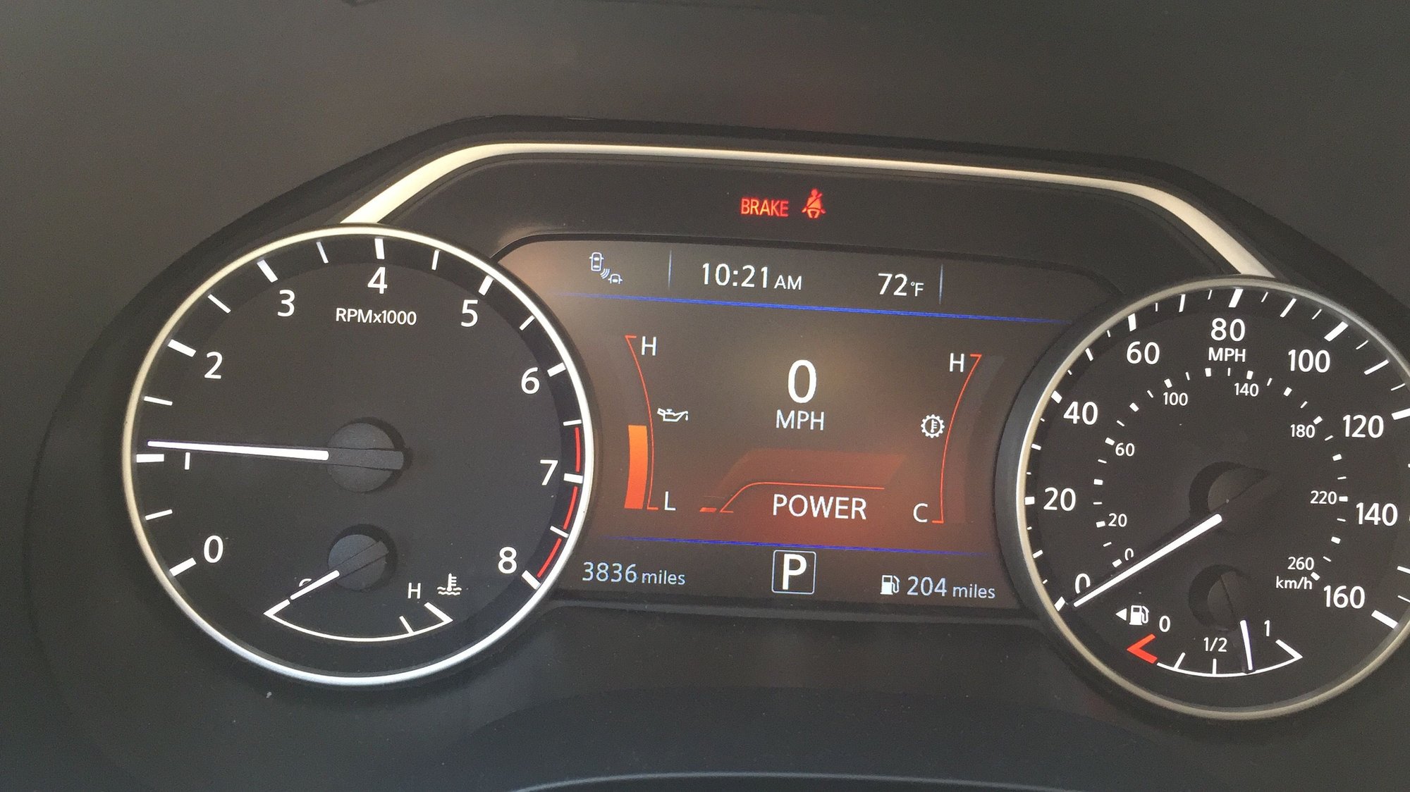

So i bought a '17 Nissan Maxima SL, but yesturday, it turn on this light and i dont know how to turn it off. I had the issue before but i just turn off the car and it will go away but it has stayed on. I dont know what to do? Should i have the dealer look at it.

So im at the dealership, today and the guys it's actually runing a program to detect any connection errors thru the sensors. I will let you guys know if the problem can be fixed at home, but i have like 3 hours here. Will let you know what's the issue.

So Nissan was not able to fix the issue, after spending about 4 hours. They told me they had to order the sensors from factory and have me come in so they dan work on the car for a whole day. Car just has 650 miles on the clock. Paid 39k and it comes defective from factory. The guy was like its an item that is back order meaning that a lot
of ppl are having the same issue and that they will call me sometime next month

THE light is off my dash
Almost a month no problem yet. Owned the car for about 1 year already love it

so they had to order the sensors, brakets that hold the sensors, it took about 5 hours total to replaced everything. They also did some testing and alined the censors. Its been a month no problem sor far.
