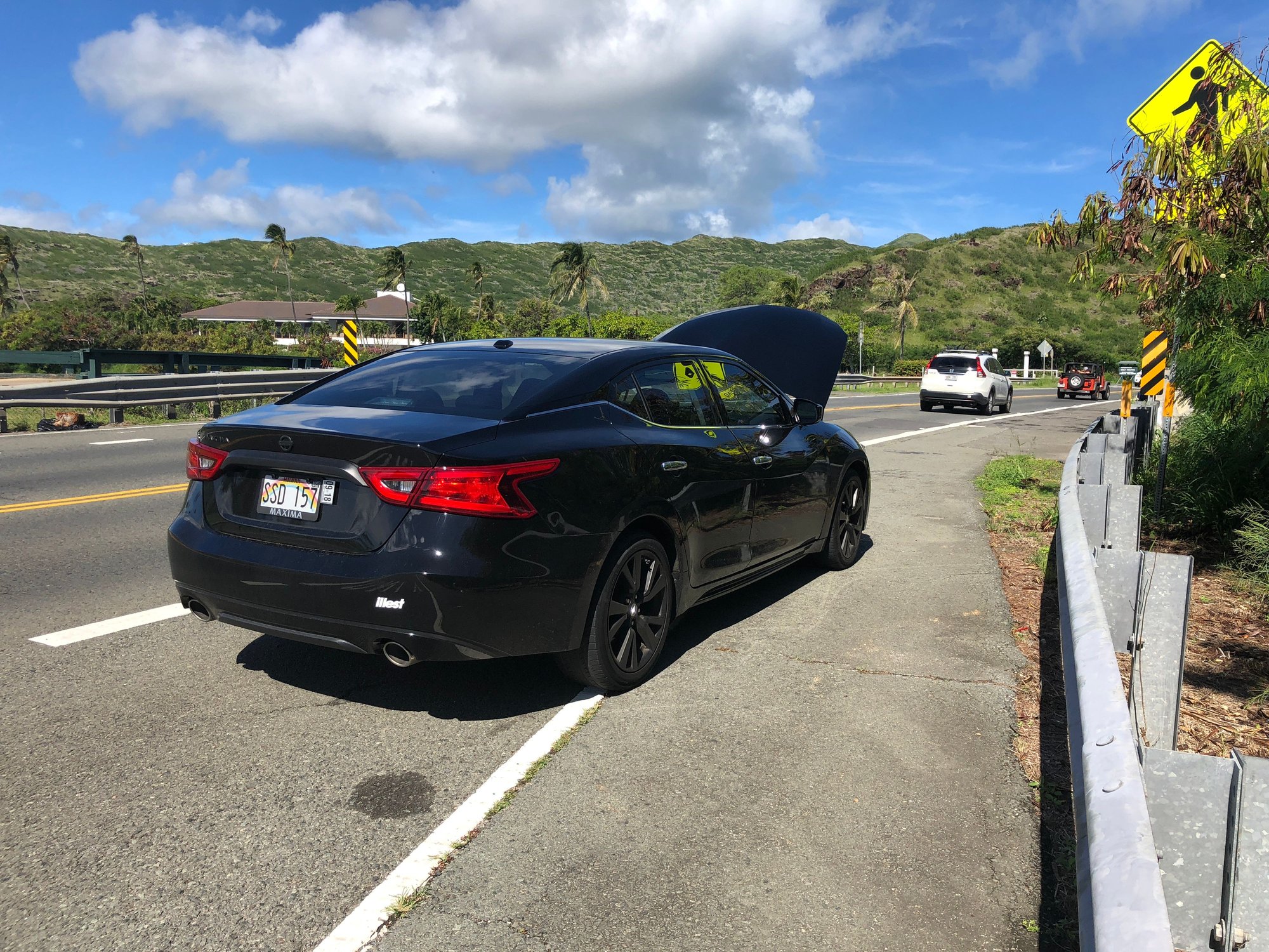

Hey guys, been 4 days since they replaced the valve body ... it’s been acting strange since then hesitating A lot more but I figured maybe it was paranoid or needed a break in period or something. Then tonight on the way home i tried to give it 3/4 throttle and it was stuck at 2k rpms wouldn’t give me power then all of a sudden shot to 6500 rpms and back down to 2 and car stuttered a bit. Ugh. Then on the freeway the cars power felt like a 4 cylinder ... super slow on the power delivery and I tried to gas it and it wouldn’t go past 70 mph and just stuck redlining wouldn’t shift...
what the hell is wrong with my car? They said the transmission looked fine but it sure drives like absolute crap... and being capped at 70 is a joke
Old Nov 18, 2017 | 01:40 PM
punkfs's Avatar
Joined: Aug 2016
Posts: 298
Left my house to go to work, soon as I put it in drive I had no power for a few seconds and the engine light and traction control light came on so I tried to reach the dealership which is about 10 minutes away... nope! Now the engine completely shut off too. Stuck on the side of the road waiting for a tow truck to the dealer . Bummer..... I’m kind of nervous to keep the car now

just got the car back seems to be running great, i really hope that was it! Man I missed this car... had an altima for the week did not enjoy it at all!
