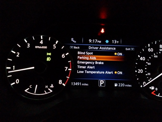

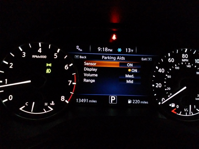

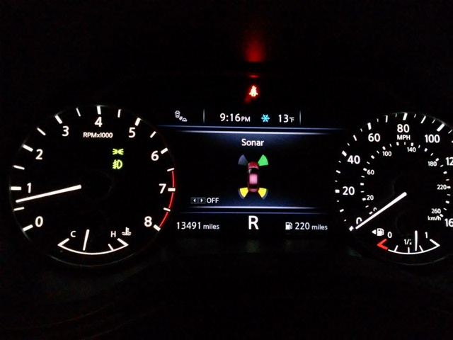

I have attached three photos showing 1.) Parking Aids in action (an air compressor is about 3' from my right bumper. The two rear cautions came on when I lowered my garage door. It is about 2' from the bumper. 2.) shows Driver Assistance main menu (where you will find Parking Aids sub-menu), and 3.) shows where you have a choice of turning Parking Aids sensor ON or OFF within Parking Aids. I have a '17 SL.
Attached Thumbnails Sonar help while parking in drive?-sonar-parking-warning.jpg   Sonar help while parking in drive?-driver-assist-parking-aids.jpg   Sonar help while parking in drive?-parking-aids-sensor-.jpg

Awesome. Thanks for the pics and mine seems to be in order. But you did not test in Drive to see if that Sonar comes up like in the first pic? All I have ever gotten is beeps as mentioned before and no visual. If you check out my first post in the video. 3:20 mark the car is in D and its showing sonar visuals just like what ya see when in reverse.

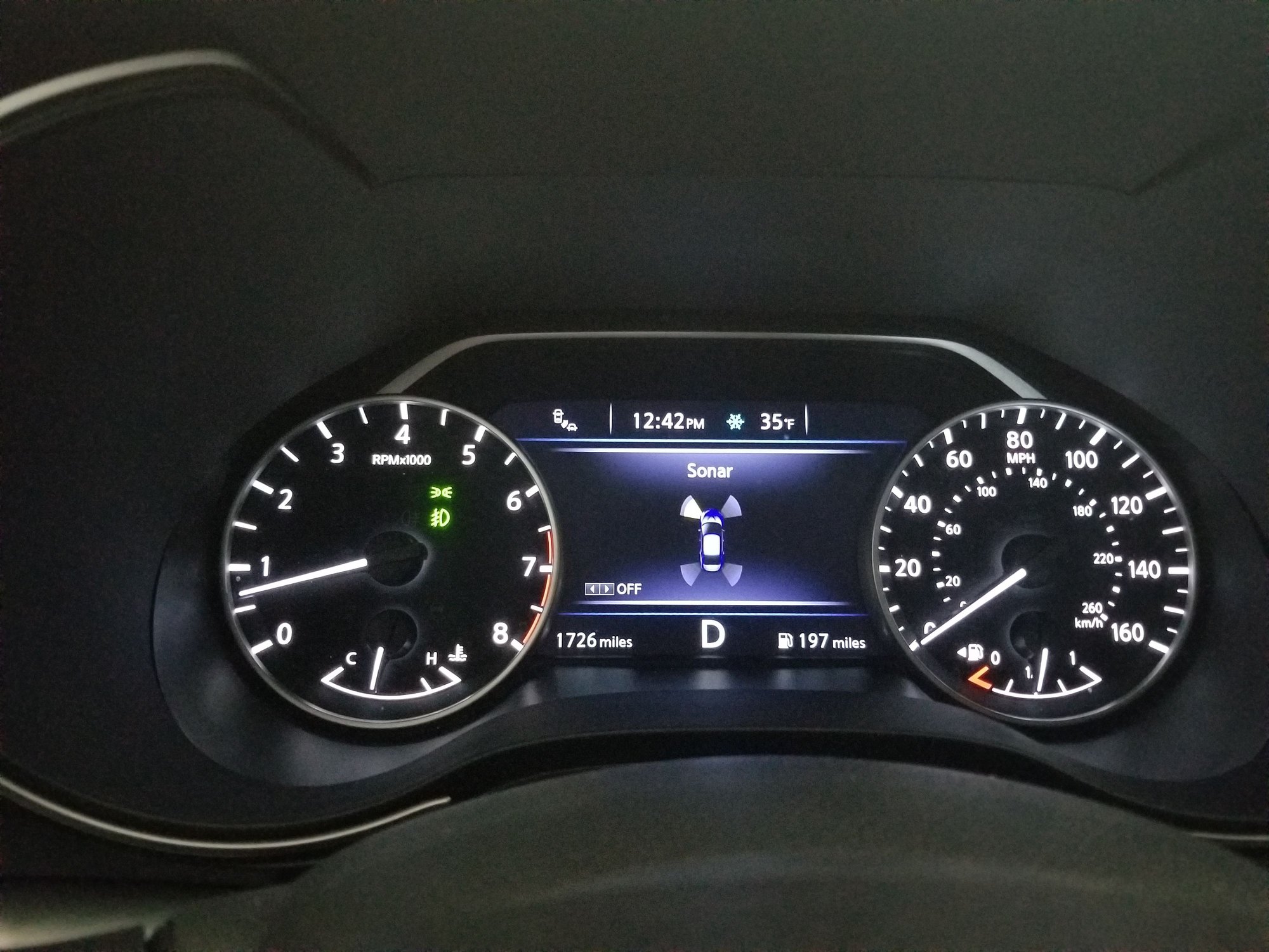

I posted a picture earlier to show that my car is in drive mode with the sonar screen but since I am new so that post is still waiting for Mod approval
Anyway, in drive mode, my car will beep first then the sonar screen will appear if I am keep moving forward. It needs to be within few inches from the object in the front of the car.

Finally I have more than 5 posts to attached picture.

FattiesGoneWild and BlueSR: I checked my graphics again today. In BlueSR's photo I see that graphic twice. The first is while backing at 2-3 mph, except on my clear driveway none of the corners are lit up. When pulling back into the garage that graphic shows up ONLY if there are obstructions nearby. If NO OBSTRUCTIONS, then I do not even get that graphic! The only graphic that is displayed under normal driving conditions is that very small graphic you see on the top line of the info center, far left. When I pass a car or visa-versa I only get the outside mirror amber caution lights but no other graphic or changes to that little graphic I just described in the photo.

FGW: In your menu you can change from short-range through longer-range to suit.
