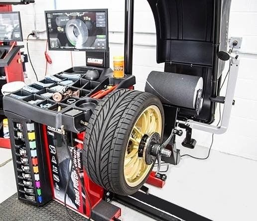

regarding the tire balance they did inspect the tire with the hunter device like this one
and then they said the tire need replacement, after replacement and the viberation still on , i notice they are putting 7 clip on tire weight that they use in tire balancing in near the edge on the rim from inside (the car side) i was sure this is wrong practice, i bring the car to the tire dealer and he said it has very bad balancing and he balance the wheel with blue macing (forget the name ) not the hunter because they only use hunter for inspection as far as i know,
and do you think the vibration is gone ? noo i feel the car is quieter now but there is some vibration in certain speed like 60 miles and i feel there is a little vibration
but the brakes vibration still there as it without any improvements
