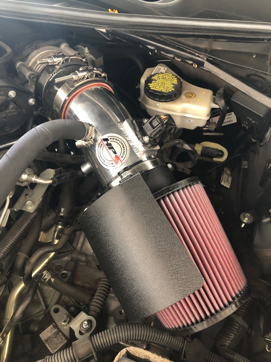

It's only the beginning, but wanted to share my intake HPS CARid
Next:
Waiting for Stillen Front Splitter and Rear Diffuser to be delivered.
Next:
I've never understood how ingesting hot underhood air can enhance engine performance over ingesting cooler outside air. Also, it seems that the metal mass air doojie would absorb even more engine heat. I'm sure someone will explain.

Get it for looks, get it for noise, get it for perceived seat of the pants gains. There is no other positive function.

They might not do a whole ton of good, but they certainly aren't hurting anything ... if you like/want them, use them. And you're certainly not an idiot (as has been inferred) for doing so.
I actually run a Jim Wolf SRI on my 4th Gen and have experienced and measured just what the narrative and data provided below shows.
Just a couple of tid-bits with some relevant information and data:
https://www.carthrottle.com/post/eng...t-ram-intakes/

I am just curious, is there a reason you went with HPS instead of Stillen? This one looks like it would block any cold air from the intake, the Stillen Intake connects to the stock fresh air inlet.
At the time of purchasing, the stillen and hps looked similar. After I purchased and installed the HPS I realized that the Stillen, had an adapter to the factory cold air. So I went to RMA this one and it has been a hassle so what I did was, re-added some of the factory cold air and rotated the heat shield. Lmk your thoughts.
Everyone should take note that the OP retained the factory air inlet tube.
Notwithstanding the questions and confusion that surrounds the use of this upgrade, this little diddy changes all of the math as far as engine compartment and therefore intake air temps.
Good move ... and I've got the air filter air temp numbers to prove it ... at least when traveling at speeds of 6 + mph.
Yep! Agreed! Thanks!
Looks awesome!
Got myself an AEM, though.
One suggestion, is getting an (AEM, or similar) dry filter water-proof(ish - because, with enough moisture, it could settle on the) net. Still, better than none at all. IMO.
I noticed that by removing the factory box, water splashes from any direction, with the factory tube now pointing directly at the filter, may shoot some water to the filter during heavy rains. But yeah, only on heavy rains.

Originally Posted by BlakMaxiJoey
Looks awesome!
Hm good point. I have the bottom portion of the factory air box.
I know here in AZ, any other weather but hot or hotter is rare, lol, well maybe during monsoon season.
I thought about re-adding the bottom portion of the box, what do you think?
yea good move otherwise you're just sucking in superheated air. I was about to ask why you didn't use one of the systems that use part of the original intake and runs into a heat shield.
So I have a question for you and then one for those who have dyno experience
1.. are you going to add a heat shield or heat wall between the motor and the filter?
2. and for the pros - These cold air intakes remove the Intake resonator and do without. They have a specific job and help to increase performance. does the performance outweigh removing the Intake Resonator? or should someone find a way to add it?
So, I do plan on putting a fire wall between engine and filter. I’m up on the fence with returning this one and getting the Stillen. I may come up with my own “firewall,” to try and trap more cold air instead of heat.

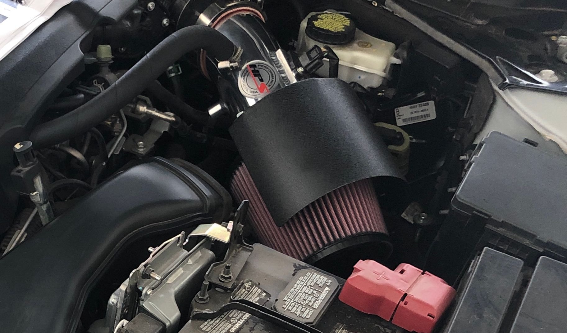

Never really thought about putting the lower box back.
Can’t picture it being there, and its purpose.
I have seen Stillen (polyurethane), AEM (aluminum), and a generic (for 7th gen?? Which interferes with shift linkage) enclosures and they look like good barrier from the engine from some heat.
Yeah - I will post pics with updates
