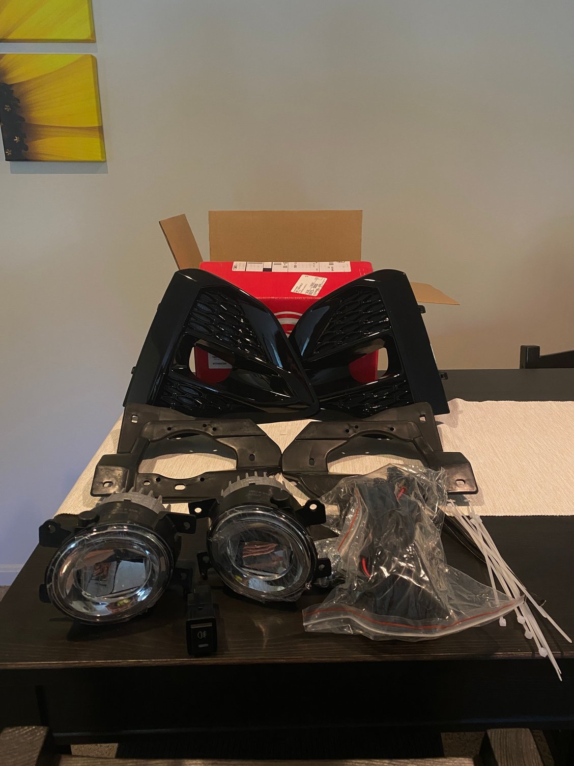

Hey All,
Just an update, received the kit today, looks really promising! you can't see it but the hardware comes with the kit, its just under the wire harness. Also instructs came with it but are just general instructions on how to connect the wires, not how to install on the specific model car. But its pretty obvious how it all goes together. hopefully I'll have some time to install them tomorrow if the weather holds up. check it out below:

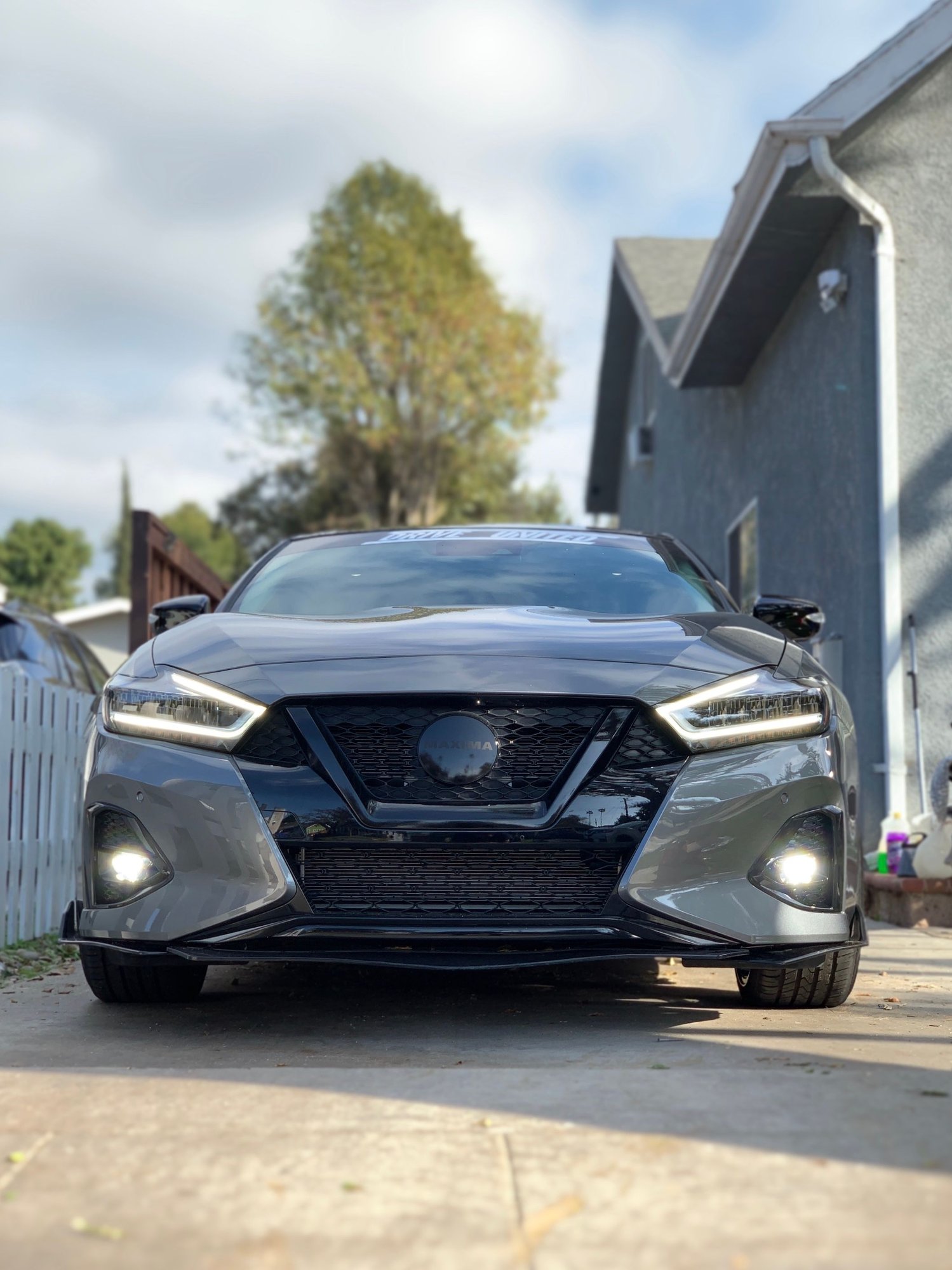

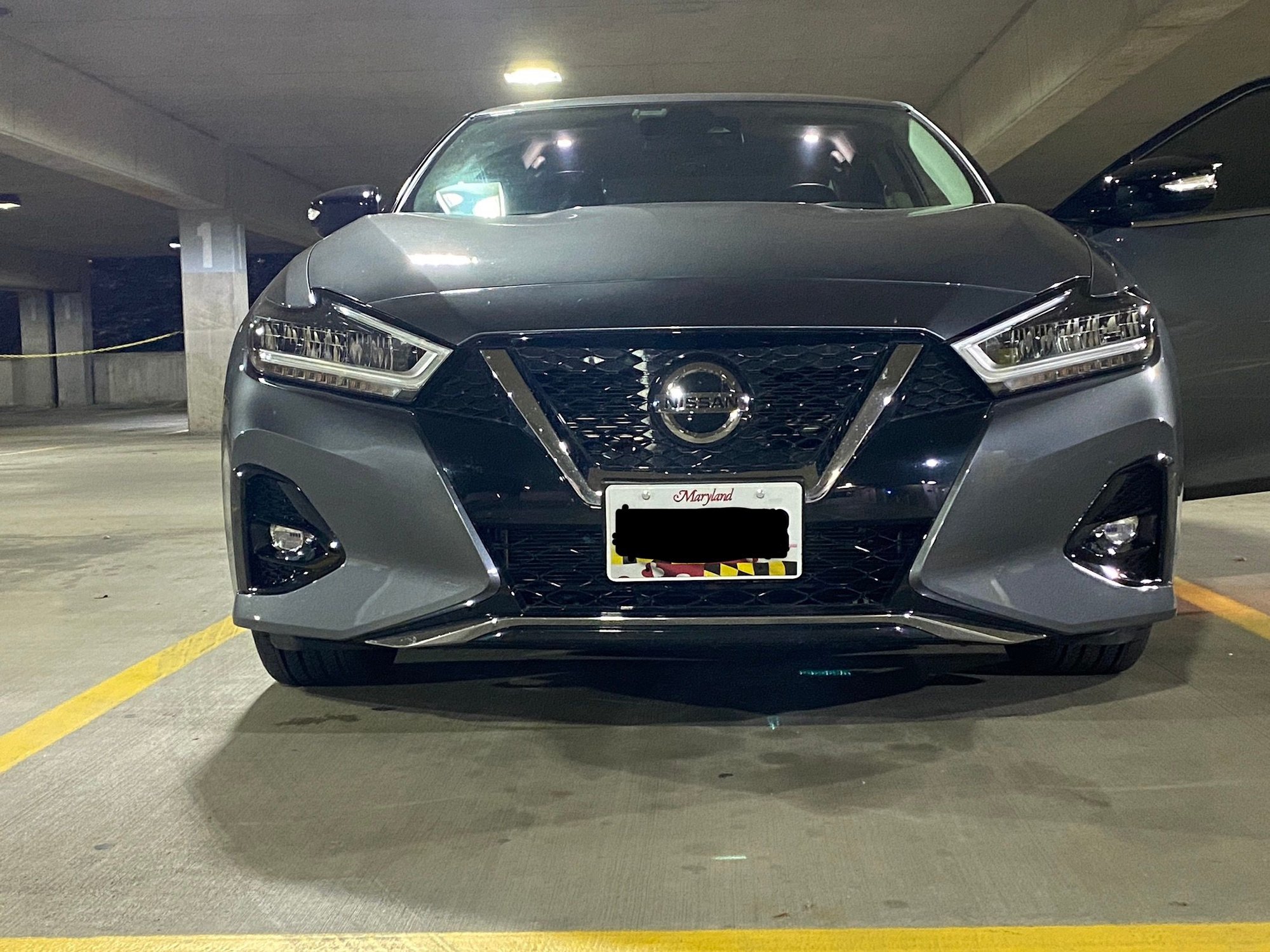

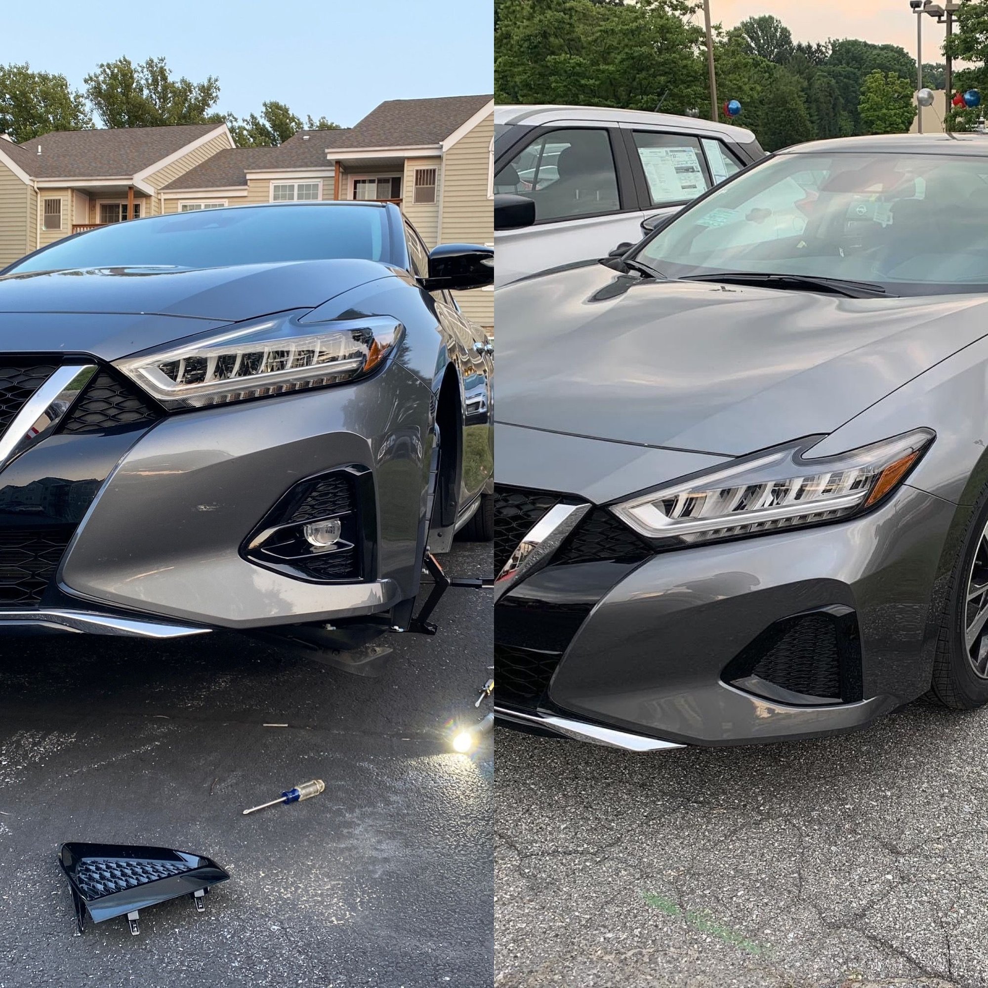

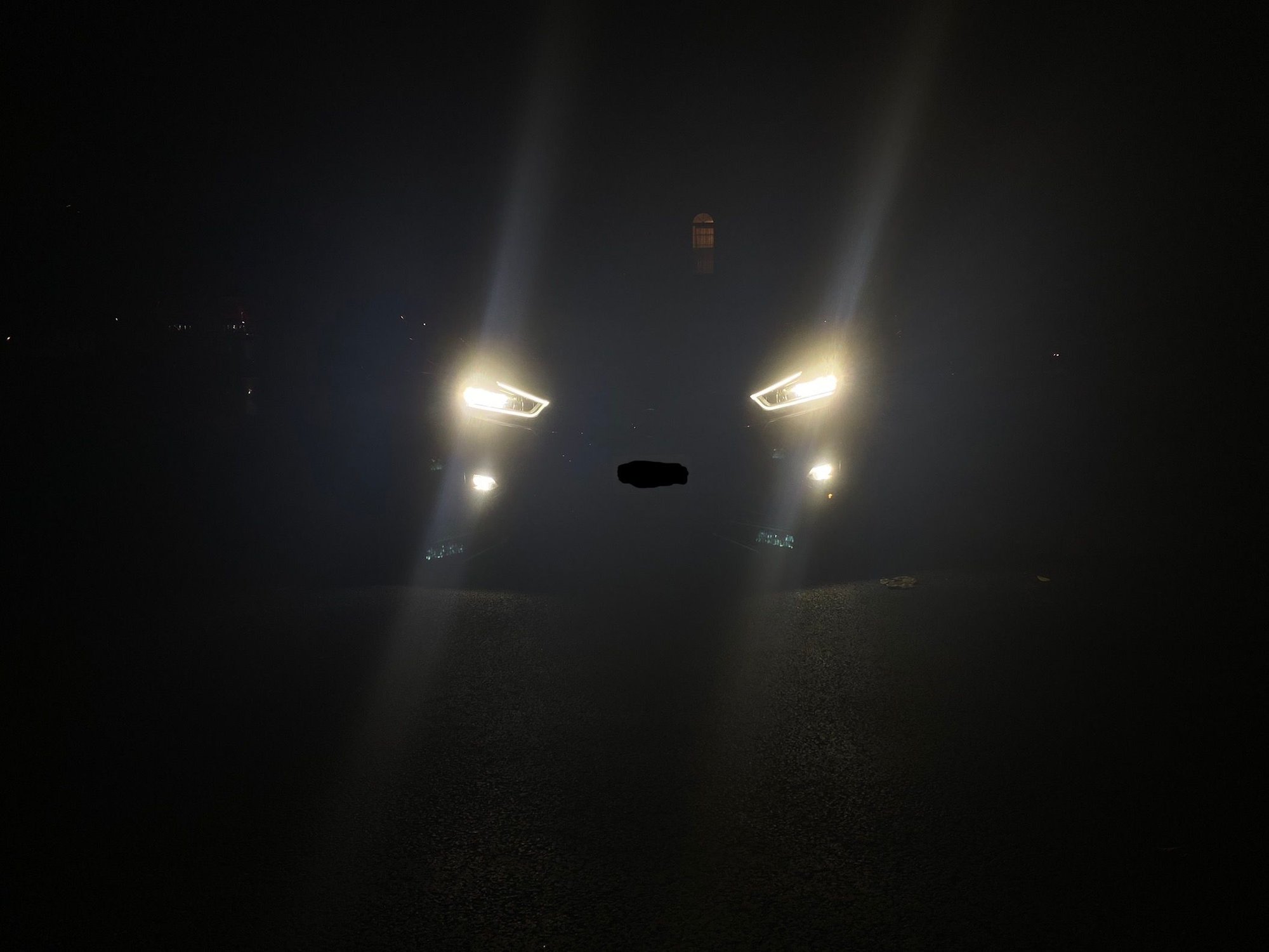

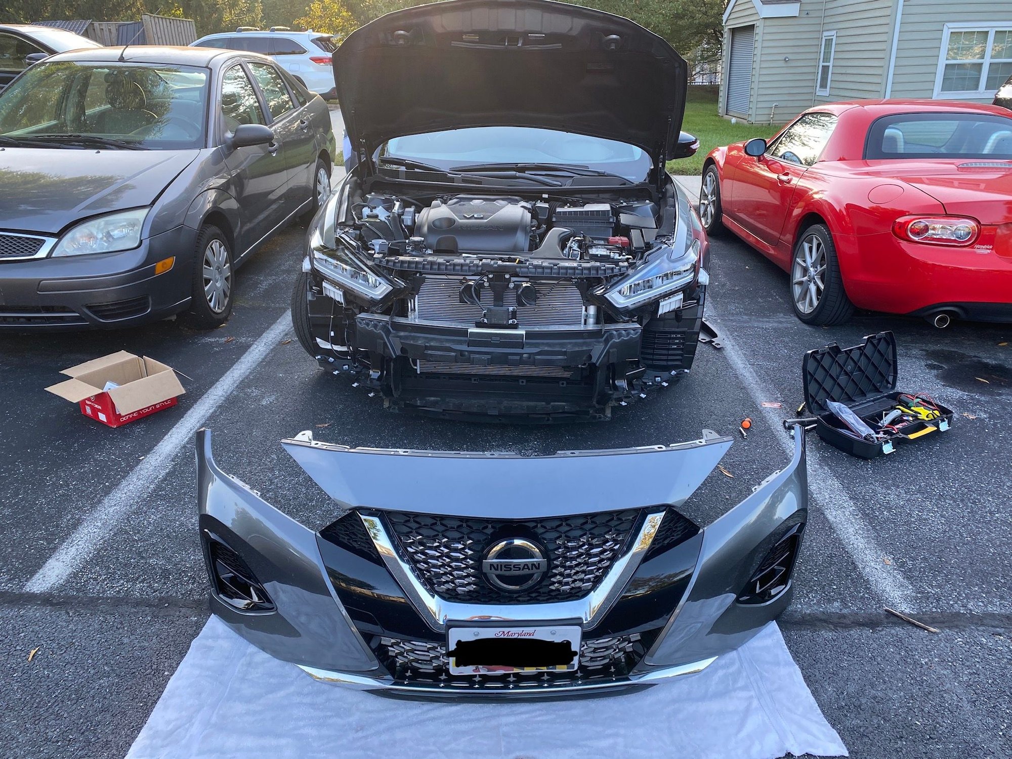

Finally Installed!!!!
Hey All!
sorry for the delay. Between work and being sick with Rona and some crappy weather I had limited time for the install.
so, the install wasn’t terrible but I definitely recommend paying someone to do this if you have never done this before. I did run into a few technical and logistical issues with the cabling but got it all sorted out. If you own a Maxima and plan to do this yourself, be aware that the main harness grommet going through the firewall is tucked away in the VERY far back right corner on the battery side. I believe you can remove the inner fender liner and access easily through there (didn’t know this until after already getting it through lol). You will also need to remove the Air Box (very simple).
air box removal - easy
Bumper removal - easy just be careful of tabs
mounting the lights and trim - super easy
cabling - plenty of cable to reach where it needs to go
i used an add-a-fuse despite the “instructions” saying to tap into the parking lights wire (not a good idea don’t do this, always use a fuse tap)
the instructions suck but honestly it’s all pretty straight forward
anyway enough details here’s the final results. I love that the color matches throughout. The only thing I hate is the on/off switch being GREEN! (Probably gonna black it out anyway)
Day 1- tried to install without removing the bumper (tip: remove the bumper. Passenger side not accessible without doing so
Day 1a - managed to get passenger side mounted but ended up removing bumper anyway another day because there’s no other way to run the wire harness and also had to tighten the screws for the lamps.
Day 2 - face lift (literally lol) didn’t get pic of the wire harness at this point
Day 4 - figured out that the fuse tap needed both slots to have a fuse (duh I’m a dummy) which is why the lights weren’t coming on. Ironed that out and here we are!
lights are not yellow btw, that’s just from the camera phone. They are white and match the headlights and the surrounding headlamp LED

Originally Posted by Evan Sherman
hey! Just posted all about it and pics
Evan,
Great write up on what could save a lot of money. The fogs look factory. Can you light them when the high beams are on? Enjoy that car!

Evan,
Thank you! Yes they can be powered on with the high beams since they are not integrated with the factory lighting. Though, its hard to tell they are on if your high beams are on.
They definitely added more visibility to the sides of the roads and you can clearly see where the light spread goes forward and out when turning them on and off

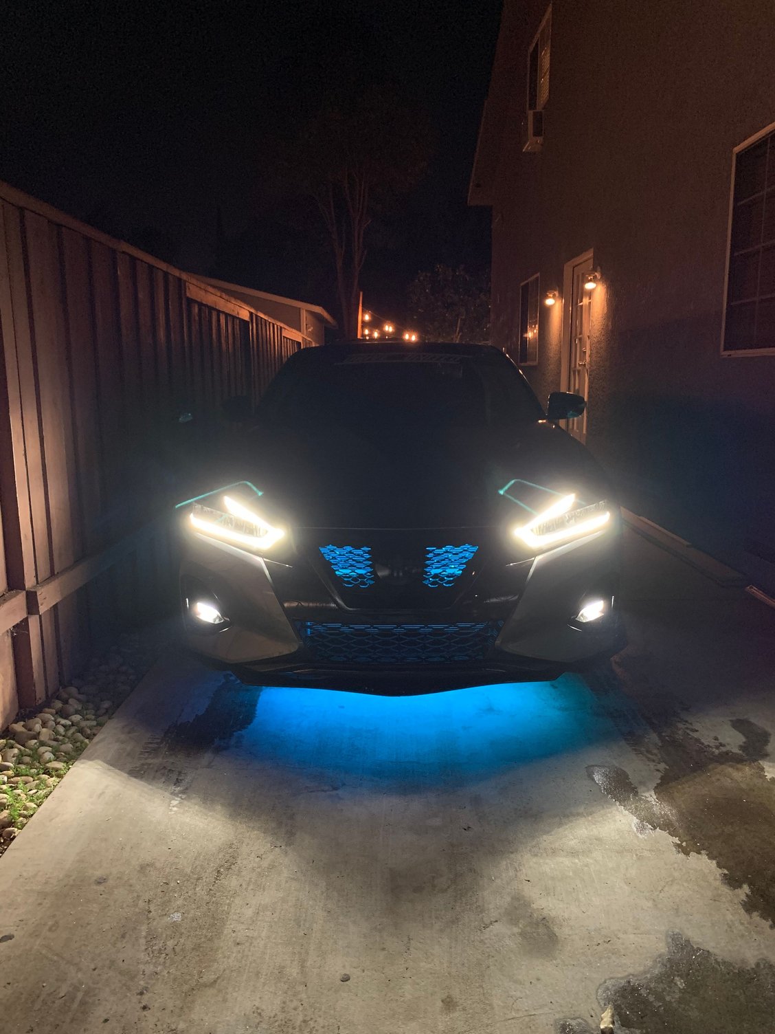

Just installed mine this weekend
2020 SL

Looks Awesome! good work! also, the underglow looks sick, i'm actually thinking of doing them as well. Since we have the same color car, its good to know they will look good!

So this will depend. If you have never done this before, ever, its going to take a while, factoring in time it takes you to figure out how to pull the bumper off and pass the wire harness through the grommet in the firewall which is CONVENIENTLY (sarcasm) located in the far back right corner of the engine bay, driver side, behind the shock. It's been a while since I last did one of these but I kind of had an idea. It only took me so long because, like yourself, I didn't have a place to work on it and had to fight the remaining daylight after work or go to a nearby parking garage to work on it. I also didn't work on it each day. All together, I put in about 4hrs of actual work, no coffee breaks

YES! Taking the time to do the proper wiring job is DEFINTELY most important. The only wire I will say is acceptable to be seen, is if you connected the lead wire from the harness to the positive battery terminal. I will always give a pass for this because usually no one has a better way of connecting to the power, unless you are fortunate enough to have an enclosed battery or one in the trunk where no one will ever see it but you and a mechanic lol

Wow Evan,
A parking lot install makes your write even more impressive.

if you look up through the thread, you will find a link to the ebay seller who has them as well as some information I posted about the install and what to expect. They were about $100 plus shipping but worth it. Not sure if they have gone up in price at all.
Old Dec 26, 2020 | 06:23 PM
Evan Sherman's Avatar
Joined: Sep 2020
Posts: 17
Wow Evan,
haha thanks! spent many hours in it. luckily its a free parking garage!
