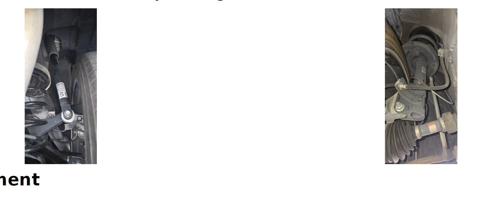

Hey all. Quick question. I had my 2017 Maxima i(with 52,000 miles) n for service and the dealership took pictures of shocks and gave me these two pictures saying they need work. The report said the front struts and rear shocks needed to be replaced. They said it was seen in the attached pictures, I am no mechanic and am at the mercy of the dealer. so, does anyone see anything in thee pictures that warrant repair or replacement? I would be grateful for any thoughts. Thank you.in advance.

I don't see any leakage around the cylinder pistons and body. How is the ride? Is it bouncy bouncy? When you push down on a corner how much bouncing before it is still? You should be OK for awhile base on your miles .

Thank you. The ride feels fine to me. No bouncing that I can notice. Again, thanks for the reply.
