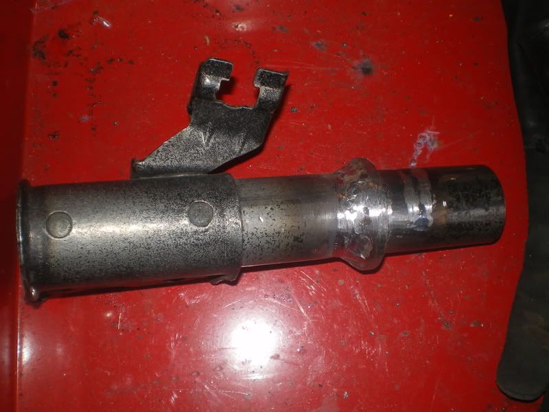

For a streamline look you can remove the original spring perch. You dont actually weld the sleeves on. You can to weld on a perch for the sleeve to rest on. When I made my 1st set over 2 years ago I didnt have a welder, thus the ghetto engineering using more sleeves. You can also leave the original perch and set the sleeve on it. I have also trimmed the perch down and bent it over the sleeve. On my B13 Sentra I welded perches for the front, running shortened B15 yellows. For the rear I trimmed the original perch and bet it over. Im running GR-2 out back so I cant weld them.
Sometimes there is a gap between the Koni insert and housing. I used an aluminum can and duct tape to shim for a tight fit. I have also used epoxy, glue, or jb weld between the insert and housing.
The adjusting sleeve's inner diameter is larger than the outer diameter of the housing tube. Wrap duct tape around the housing until the sleeve fits snug. I like to RTV the sleeve on also. Some have used heater hose, rubber rings, etc to fill the gap. I like the duct tape method.
Joe, 98SEBlackMax went all out with the helper springs. What this does is keep the spring seated at all times. The GC springs are short, 7" up front. When the wheels come off the ground the spring can become loose and unseated. Not entirely necessary for daily use, though some states check springs during inspections and you can fail if they are loose.

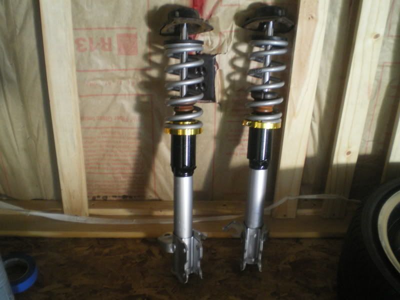

Sentra, welded:
Sentra, trimmed and bent:
Maxima, stock perch for regular springs, I did these for 95maxrider:
