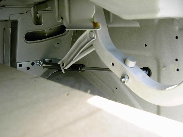

did a custom trunk lid system normally when you push the button on the drivers side door of the maxima the trunk lid unlatches now the way i have it set it when you push the button the trunk lid goes all the way up by itself. used 2 hood gas shocks and made the brackets

Innovative idea with the gas shocks in the trunk!! What vehicle was the gas shock for, do you have a part#? I never thought of it that way. I think I can finally fit a 15" sub, in a properly constructed box, in the trunk. The only thing that was stopping me then is the tension bar that runs across from under the rear deck. Gotta start measuring stuff and maybe I can slap on my JL15w3 in it.
Port-thru design is the baddest setup of all for SPL! It alleviates major pressure from the trunk and feeds all that soundwave thru the port and into the cabin. The trunk won't fall into pieces unless you use one of these. You feed that with big power and forget about the rest of the car.

Great idea using hood struts to pop the trunk.

dr-max Innovative idea with the gas shocks in the trunk!! What vehicle was the gas shock for, do you have a part#? I never thought of it that way. I think I can finally fit a 15" sub, in a properly constructed box, in the trunk. The only thing that was stopping me then is the tension bar that runs across from under the rear deck. Gotta start measuring stuff and maybe I can slap on my JL15w3 in it.
no i dont have a part number for the gas shocks i just measured and when to the parts store and looked at what they had and bought something that i thought would work and it did
and for the port thru box i had to cut the tension bars

dam that was smart with the gas struts.. im doing that now!

Well done with that trunk opening. Did you get them at a boating store? I definately want to do that if/when I run subs IB on the rear deck. any more detaled pics of this would be appreciated. VERY COOL
