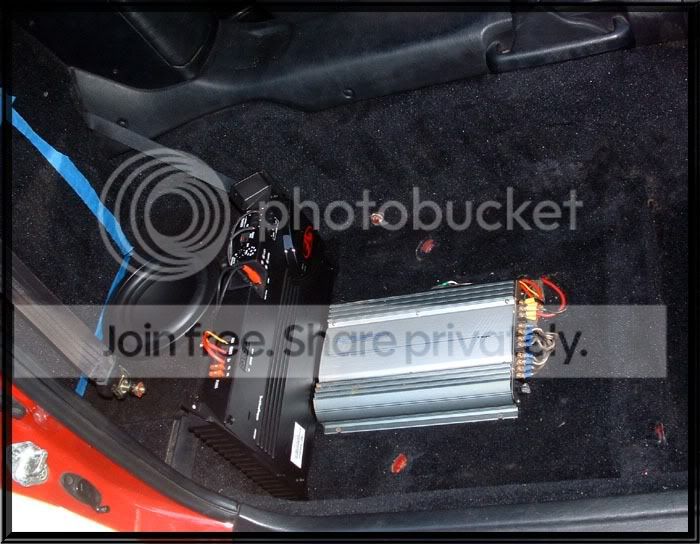

So...putting together a system for a buddy of mine in his 91 MR2. Space is very limited since any install would have to be in-cabin and directly behind the front seats. So far, he's debating on either four Ascendant Audio Assassins 8's or four RL-i 8's. Whatever he chooses will be powered by his Kar 900.1.
Now...I can't fiberglass (more like I don't know how ), So if I used 1/2" MDF, instead of 3/4" to get the most airspace as possible, will it be OK if I braced the insides with some 1/2" wooden dowels to minimize flexing? Or can I just cover the inside with a layer of resin?

that was Mike's (of Sound Splinter) MR2 before he changed vehicles. that's one 8...
