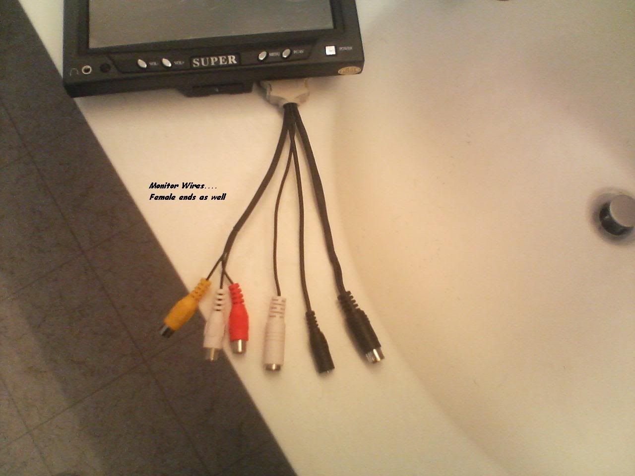

Having a slight problem with my Touchscreen Monitor Install.
First there is
They are female ends..........
Then the monitor has female ends as well............
Do I need Male to Male connectors to make it work???

just go to radioshack and get the two sided male connectors

1. male to male RCA connectors - radio shack
2. that will help your video problem - the video coming from the HU (yellow) goes INTO the monitor (yellow)
3. The audio (red and white) from the HU goes into your stock stereo system. If you have Bose, use Metra 70-7551.
4. The link above works for the screws. TIGHTEN till you hear the click, then loosen.
