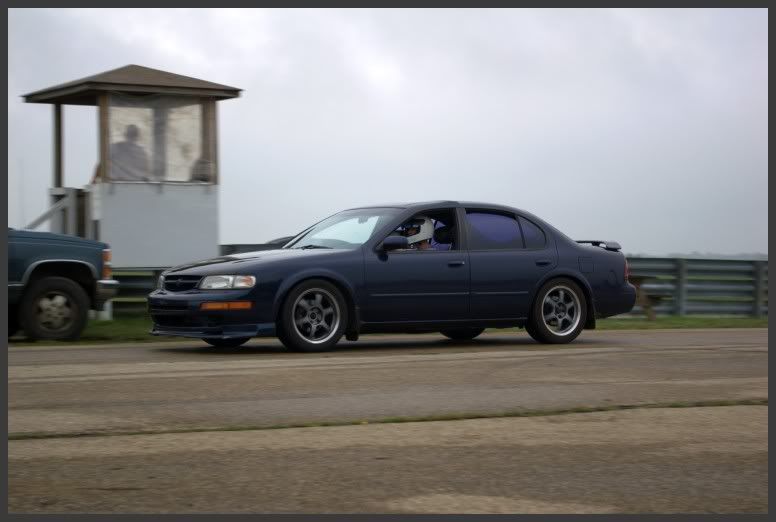

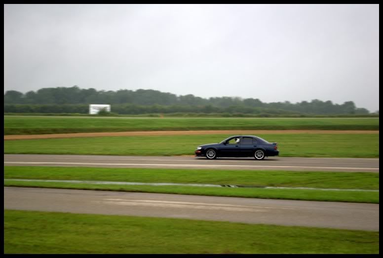

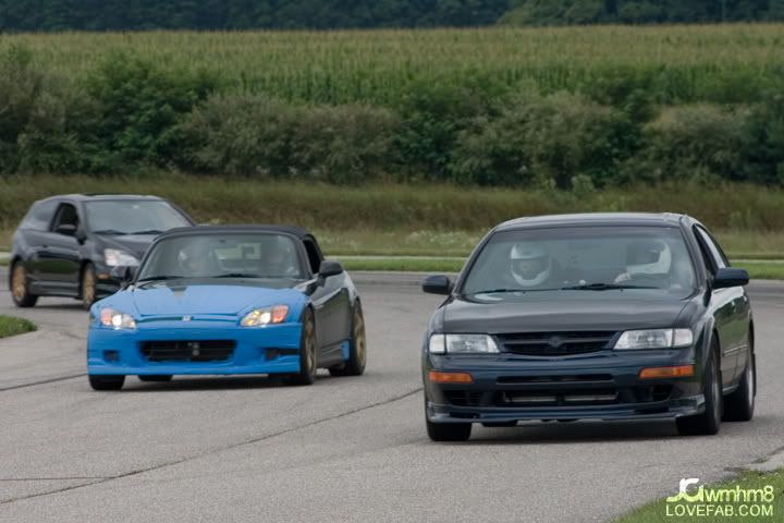

Took the max to the road course for the first time since '04
I signed up for a two day event at Gingerman Raceway and then had a mad rush to get the max ready for the event. I haven't driven on a road course since 2004 I think, so I needed to get back in the groove. I forgot how fun it is. Saturday was rainy all day and I only went out for one session - wasn't terribly fun running a 3/10ths and still feeling like I was on pins and needles trying to keep the car under control.
Sunday though dried out and I got back at it, and had a blast. The basic setup of the car is:
95 SE 5spd
3.5 swap w/ 4th gen intake manifold (no power above 5300ish) and 4th gen timing
Quaife limited slip diff
PPG 3rd and 4th straight cut gears, shot peened
Shot peened, detailed and deburred 1st through 5th gears
Oscars Radiators 1.5" all aluminum radiator
short ram intake/Ypipe/3" exhaust
K-sport coilovers
generic front strut bar
Cattman rear sway bar
J30 calipers front
z32 rotors front
Goodridge SS brake lines
Carbotech XP8 pads in front
Hawk HPS rear pads
17x7.5" SSR Competitions
Kumho MX tires in front (245-45-17)
Hankook RS2 tires rear (245-45-17)
PLX Devices DM100/SM-AFR/SM-Fluid temp gauges (oil temp and water temp)
I was pretty happy with my performance and that of the car. The Quaife limited slip is pretty awesome - you can get on the power so early coming out of the corner it's incredible. The 3.5 has good grunt and this track can be run in 3rd gear the entire time with the power level I am running. I could have shifted into 4th in the straights and 2nd in the corners but after a session of trying that, I decided to save the wear on the trans and keep the car in 3rd the whole time and just concentrate on running the proper line and hitting my braking points.
This brake setup never missed a beat, pedal feel was consistent and solid the entire time, what it really boils down to is I had way more braking power than traction, so the brakes were not even close to being pushed to their limit.
I started out in Intermediate II (the higher of the intermediate classes) because I hadn't been on a road course in 4 years. I ran a couple sessions in Int II and was running over everyone so I moved up to Advanced I (the lower of the advanced classes) in which the split is about 50-50 cars on R compounds vs cars on street tires. I was middle of the pack in Advanced I.
Handling of the max was interesting - you can tell it doesn't handle or grip as well as the smaller/lighter cars but for the most part I was making up for the handling deficiencies under braking and somewhat under acceleration as well. I'd say braking was my biggest advantage over most cars out there and truthfully, I wasn't really braking at 10/10ths. I picked braking points and pretty much stuck with them even though as the day wore on I sincerely felt I could take it another 50-75 feet into the corners on the ends of the two straights before really getting on the binders.
My coolant temps were rock solid 195 degrees the entire time out there (temps were high 70s low 80s). Oil temp was a little on the high side, 260-270 degrees. Not out of this world high but high enough that I'm going to run an oil cooler before the next time i run out there (next time I'm out there I'll probably be turbocharged anyway, in which case I'll obviously need an oil cooler). Power steering never boiled and neither did the Valvoline SynPower brake fluid.
I've got in car video from each of my sessions that I'll post up eventually, and I've found a few pictures that different people have posted from the event that have my car in them, so I'll post those as well. Should have some external video of my car available pretty soon too.
Credit for these photos goes to Lovefab, briangaudy, cleanblackZ, etc. None of these were taken by me.
