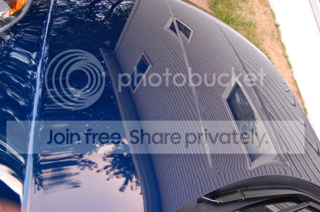

My wife has an 07 Altima...Majestik Blue...I thought I'd throw a few pics up. I spent the day detailing the exterior. These are the steps I used:
1-wash the car
2-dry the car
3-clay bar the car (was able to skip this step as I clayed it last month)
4-Buff car using Wolfgang Total Swirl Remover w/orange pad and Flex polisher
5-Polish car using Wolfgang Finishing Glaze w/white pad and Flex polisher
6-Apply Wolfgang Deep Gloss Paint Sealant (car must "cure" for 12 hours after applying sealant...you cannot let the car get wet while the sealant is curing)
7-Follow up the following day with a quick wash/dry and a coat of Pinnacle Souveran past wax.
I purchase all of my supplies from Autogeek.net
Took me the better part of a day to complet steps 1-6...I haven't gotten the wax on it yet. It's a lot of work, but this color looks stunning when it's finished!

WOW! Thats hella shiny. You can see the clouds off the top of your wife's Altima. How long did it take you to do all this?
Old Aug 5, 2009 | 08:48 PM
1hawaii50's Avatar
iTrader: (14)
Joined: Oct 2008
Posts: 888
From: Brook Park, Ohio
Most of one day to wash, dry, and buff the car with Wolfgang Total Swirl Remover, followed by Wolfgang Finishing Glaze. Finally, A coat of Wolfgang Deep Gloss Paint Sealant.
