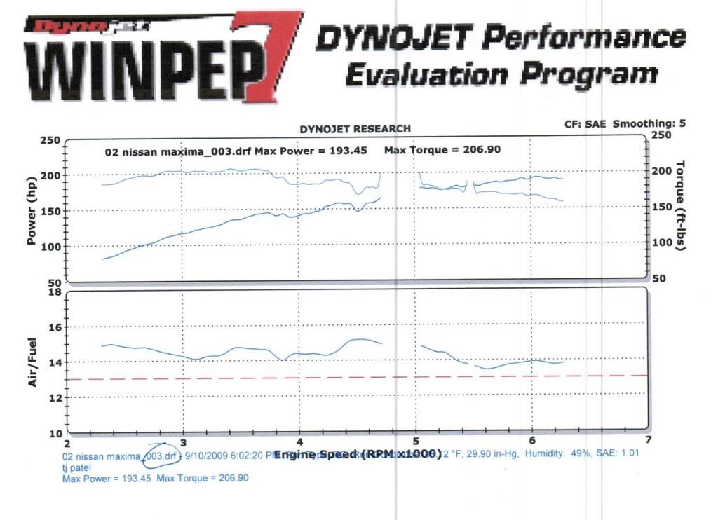

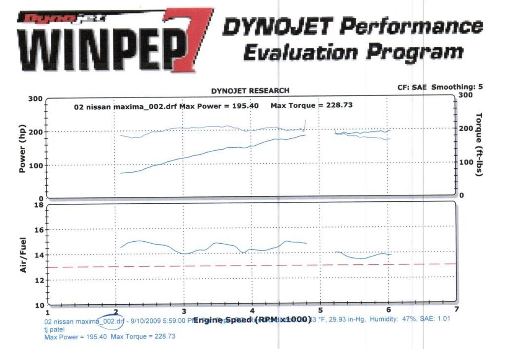

did the run before i put the headers on. i bought the emanage blue to tune the the a/f out cause its so messed up. i think i have the lowest number for the 6mt??
1st Run 3rd Gear
2nd Run 4th Gear
3rd Run 4th Gear

those #'s seem low, with just a wai i did 218whp/228tq. how many miles on the car?

yea... seems a tad on the low side to me, any CEL??

just a little misfire now and then

yeah i am going to after i install the headers.. those pulls i did was without any cooldown for driving for almost 2 hour straight. could be the reason so low?

Looking at your AFRs...
...if they're above 14:1 at WOT then your knock sensor might be trippin out trying to prevent the engine from grenading itself...

Numbers are a tad bit low kiddo do a compression test and see whats going on in there.
