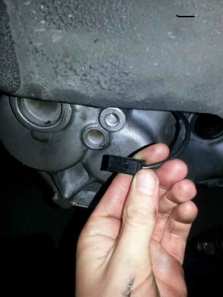

also I have a ground connector that I can not figure out what it connects to. driver side grounded to fenderwall by tranny mount under spiral tubing.
