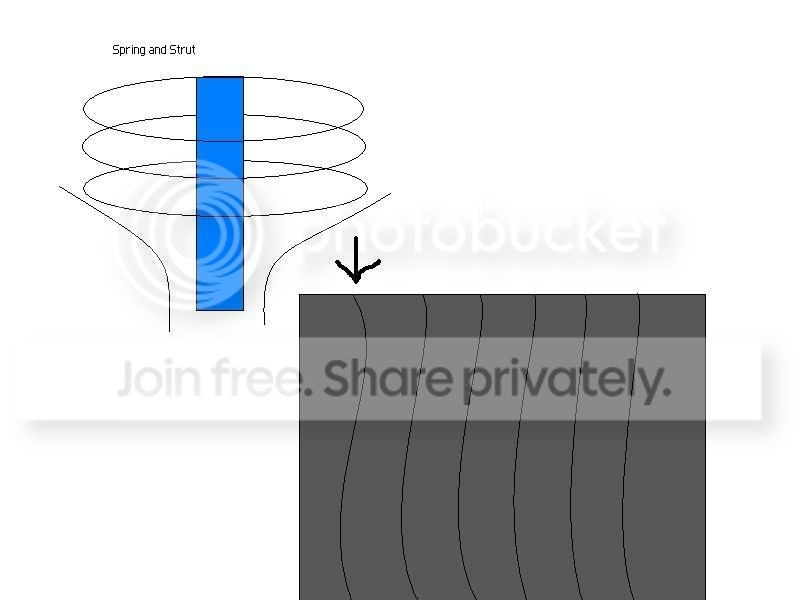

Here is a horrible picture of what is happening. The big black box is the tire. It's rubbing right where I put the arrow.

You're running stock-size wheels and tires, with what struts? the only way that could be rubbing there (that's part of the strut you're picturing) is if the tires are WAY too big for the car, or you've got struts too small for the car.
either way you need to get it fixed.
can you pull the wheel off and get a picture of the contact point on the car?
I'd also like to see a picture of the tire itself across the entire tread and maybe one of the tire on the car. you should be able to see it rubbing even while the car is jacked up.
