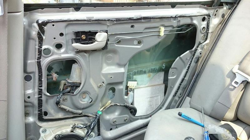

Here's where I can get to. But I still can't get the door open. The rods move well. They seem to have full travel, the door just won't come free. I keep hoping for an emergency release, but I just can't get anything in here to open the door.
I'll try just about any ideas the forum has. In the mean time I'm going to go look over some more exploded views of the assembly and see if I can find anything that's out of place.
