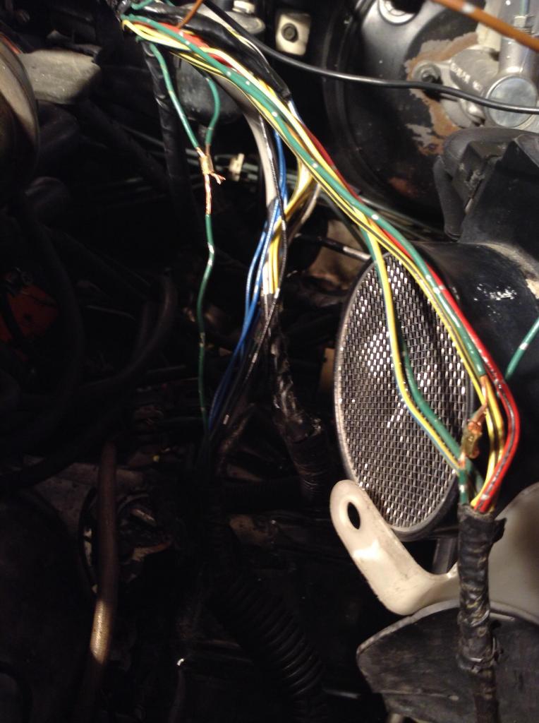

I have no pulse power going to the 2,4 and 6 injectors on this Gen3 1991 Maxima. Ive heard it never had much power before the timing belt blew and this is probably the culprit. I replaced the engine and installed new timing belt on the replacement. Looking at this set-up and it doesn't jive with the wiring diagram but being "Not a mechanic" I thought maybe you guys who know these cars might be able to help. Here is the harness that comes out of the Main Wiring Harness: Name:  imagejpg8.jpg

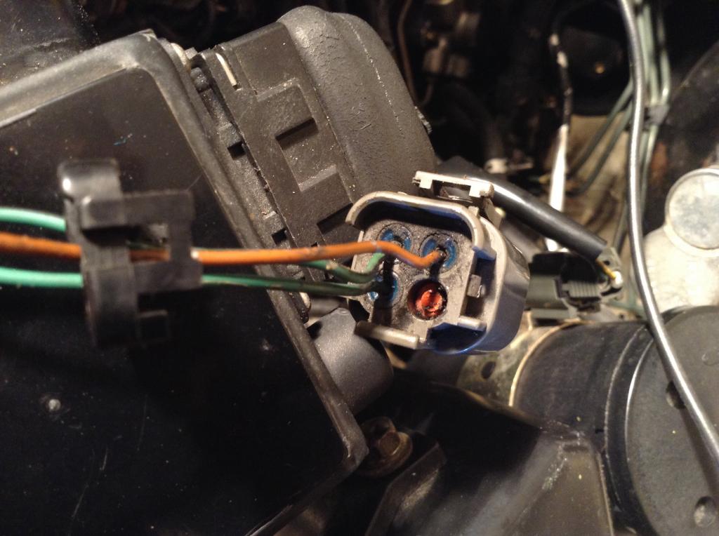

It, as you can see, has only 3 wires. A red plug in # 4 which, if my deductions are correct, is supposed to feed injector #6.

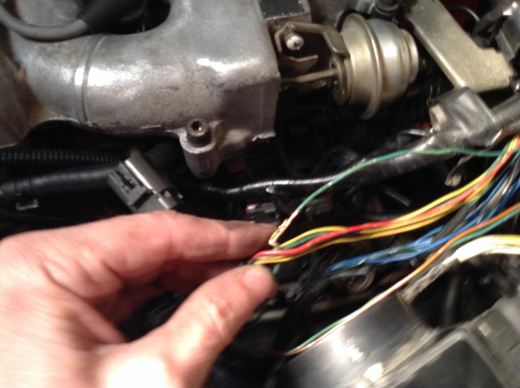

1 of the pins has constant 12v current when the key is on and heads up into the main harness. Another one splices into the AAC harness here:
Coming out of the main harness in the same group as the 2 other FI wires is this wire that splices into the transmission harness wiring with the same small brass crimp splice.

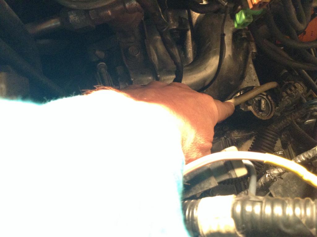

It splices into the harness that feeds this jacketed AT wire harness.
So, it looks pretty weird. A couple questions come to my "not a mechanic" mind.
1) should the plug on the main harness side have 4 wires going into it? In my mind...reading the wiring diagram, there should be 1 for each injector for the pulse signal and 1 for the power.
2) dumb question probably but...did Nissan ever splice like this or is this another backyard mechanic like me. . Doing his best to make it work?
3) where do I go from here to get the power to the injectors in the right firing order?
4) because I have only 14 posts is anyone even going to reply.
Any help would be greatly appreciated!!!!!

I was commenting when I pulled the motor that it's awesome that All plugs are unique on this car .......I see now that that's not exactly true. All unique except the 4 prong to the injectors fits the 4 prong to the tranny. Ya.... I was sending pulse power to the tranny and shifting the injectors. :-/. Hahaha. I found the right four color wires coming out of the harness and followed them to a 4 prong plug. Jaw dropped. Then I danced. Hahaha. Not a mechanic felt pretty silly but....I danced anyway. Hahahaha. Thanks to those that replied!!! It's what makes these boards so helpful and successful. Not post counts and Senior Member status....I am a Sr Member on a number of boards but I don't get involved in the drama...just there to share and help. .
Aloha all and Mahalo again!!!
