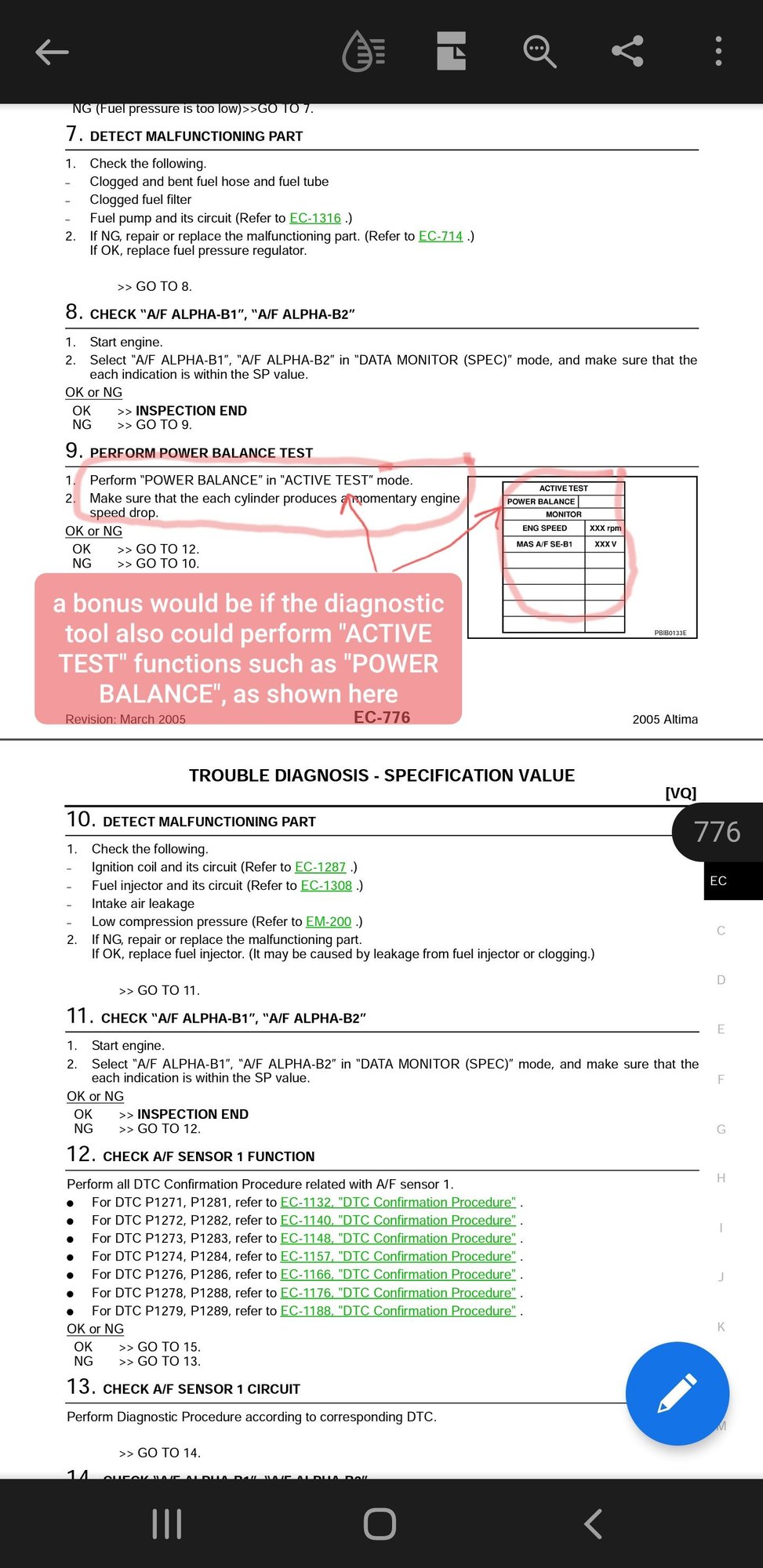

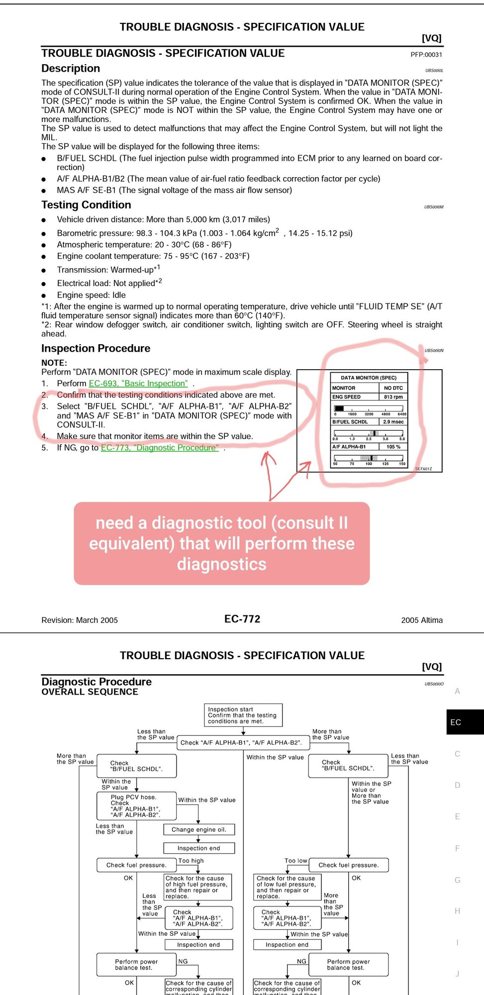

Im looking for a diagnostic tool that can be used in place of the consult II. I have attached some pics from the fsm where it details a few of the procedures are that need to be performed.
Its basically the "DATA MONITOR (SPEC)" function, that I'm looking to perform. I need to pull up the data for these spec: “B/FUEL SCHDL”, “A/F ALPHA-B1”, “A/F ALPHA-B2” and “MAS A/F SE-B1” in “DATA MONITOR (SPEC)” mode....these are what the data sets are referred to on Consult II.

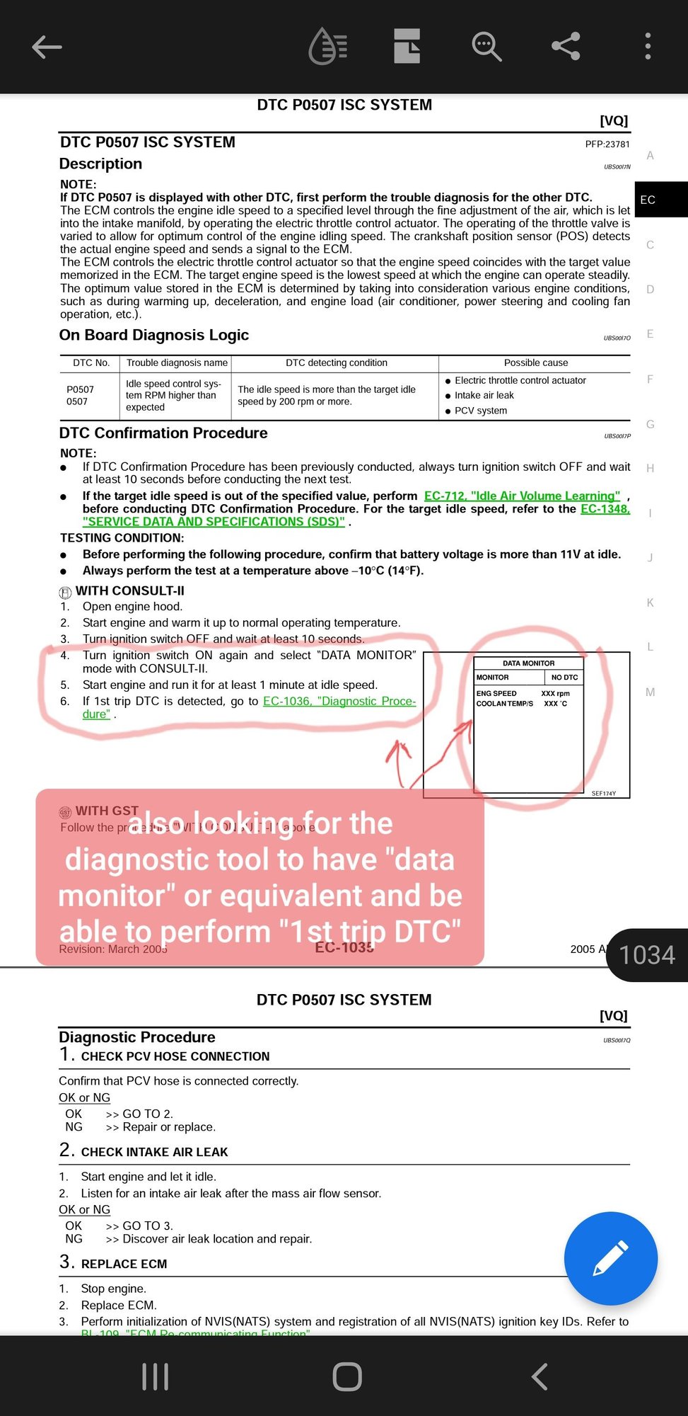

The other two functions I need are shown on the attached screenshots.
Anyone that knows of any diagnostic tool that will perform these function, please advise. Thanks in advance.
