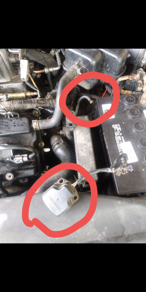

What are these
Does anyone know where these go?

That curved tube (red circled at the photo top) appears to be your transmission vent tube with a bolt/screw plugging it.
Nothing “goes” there, including that bolt.

Yup, as was said, get rid of the bolt in your tranny's breather tube and do a drain and fill of the fluid while you are at it, for that fluid is probably cooked!

The bottom thing is the electronic part of the front motor mount.
What generation Maxima are we talking about here? What year is your Maxima? Looks like a 3rd gen.
It's a 3.5, most likely an early 6th gen judging by what little to go on like EGR.
