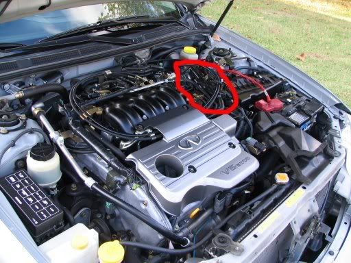

I've looked and looked and looked for details about this topic, but to no avail. The question is that, because the 2000+ I30s/Maxs have that "variable intake" thing... do I have to keep that box behind the air filter that is shaped like a notebook binder? (circled in red here)
Does that box have to do with the better power we get because of the variable intake, or is it better to just delete it?
So, to pile all this into one question, is it better to have the full intake kit from berk technologies(tube, MAF adapter, cone, and all) or purchase just the filter and installation kit (for half the price) and keep the box thingy?

I wasnt talking about ADDING power. I'm in it for the sound. My concern is I'm worried that if I remove that box, which I believe has to do with the "variable intake", that I would have a LOSS in power.
Why I ask that is because Devin (who obviously has an air intake) has added the variable intake from the 5th gen to his VQ, resulting in HP gains. However, he still left the 'binder-shaped' box there. I'm wondering if I remove that box, will it result in a LOSS of power.

That box has nothing to do with the VI. It is a Helmholtz type resonator. It aids in delivering smooth power, not rigid or choppy.
Adding a straight path (midpipe) to the intake will result in a loss of power @ 5200 and a gain @6k

Yeah, NmexMAX is correct. That plastic resonator has nothing to do with your variable take. There is not really a need to remove it either. So you can go with the cheaper intake kit if you want.
